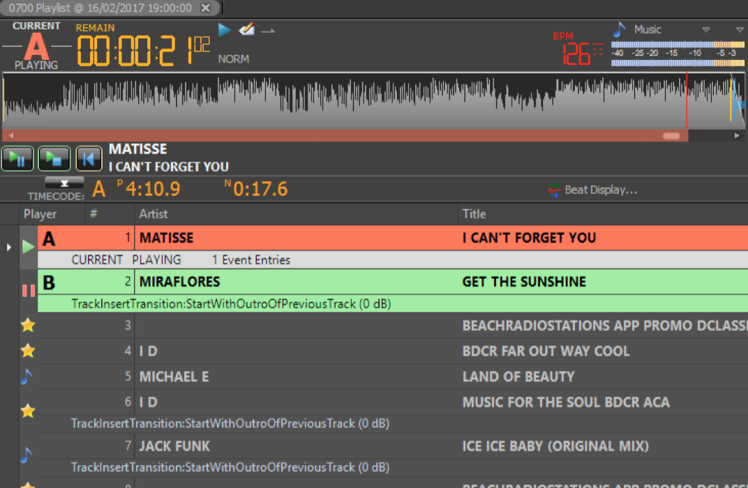

Good afternoon,
I am testing the latest version and I see in my playlist StartWithOutroOfPreviousTrack after each jingle which I do not want.
How or where can I uncheck this option?

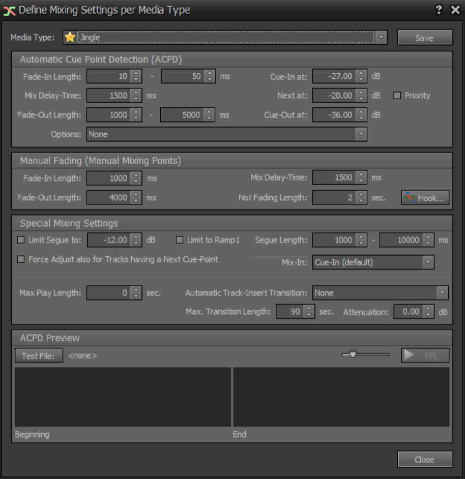

In your script?
In your general settings, section Mixing - 'Mixing per Media Type...' - see the Automatic Track Insert Transition..
There are various options - which options/settings have you changed? As ProppFrexx is NOT doing this by itself!!

Hello bernd,
I know that PF did not do this by itself. I did and don't know how I did it, sorry... maybe my Alzheimer was playing a part ;)
I checked all the media types and everything is on NONE.
I even restarted Pf but they are still there :(

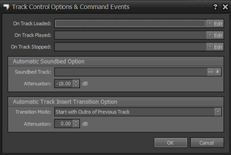

Problem solved thanks to the help of a colleague :)
Was looking in the wrong settings
