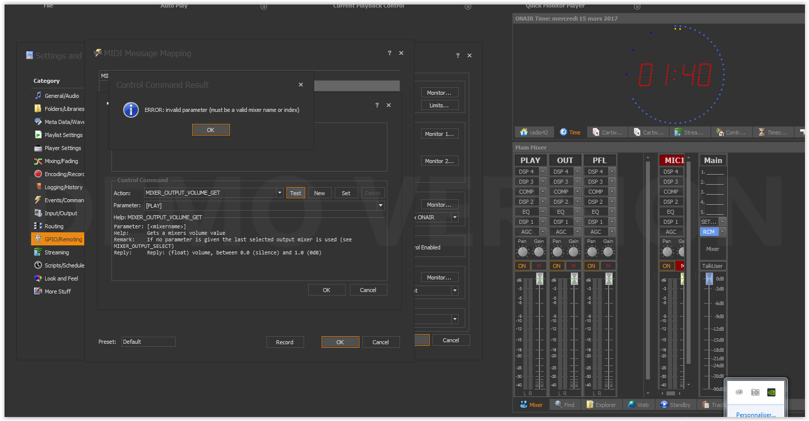

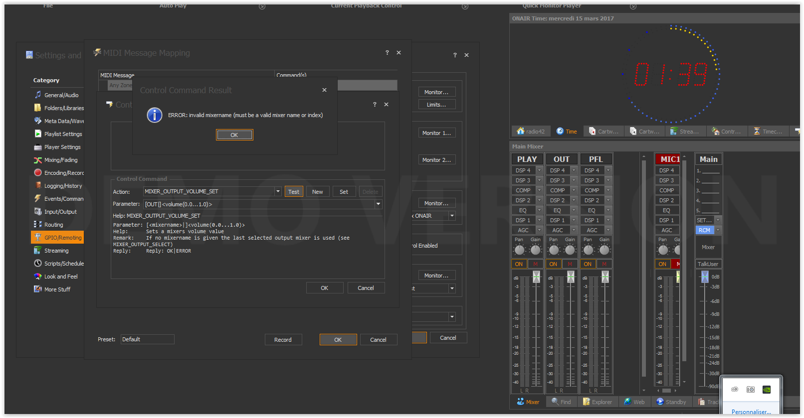

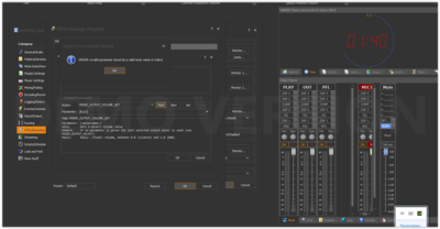

Hello, i would like to know what command to use for sliding the fader on the mixer with à midi controller.
I try to use different mixer commands but when i enter the name of the desired mixer instead of "mixername " it says error, please enter à valide mixername value, but it's right name of my mixer charnel.
Could any one help me ?
Thank you in advance.

Maybe you show us the exact command you are using, then we might tell you what is wrong.
Maybe you still included the <> brackets?

As assumes above. The brackets are still there and need to be removed. And I you need to use a macro to translate the midi data2 to the fader volume.
Take a look to the link I posted, it contains an example:
MIXER_OUTPUT_VOLUME_SET PLAY|${mididata2asvol}
Note that in the Control-Command-Builder the following applies (click also on the small ? Icon at the top right):
<> brackets denote a parameter
[] brackets denote an optional element
