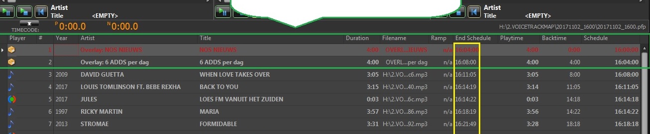

Another phenonomen is showing in the playlists off the remote voice trackers, see the pic. I guess thats something we activated in the General setting, how to default it again?

I must say, that I don’t understand what you are saying. I also do not understand what the screenshot should show me?!
Please explain in more detail what the issue is about your remote voice tracking?!
Please also indicate what exact version you are using.
The marked log entries also doesn’t seem to match your screenshot. So all a bit puzzling to me.
