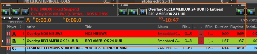

What is this?
How to fix this?

For instance, we deleted all . layout and .toolbar files like you asked, then we rebooted and the scheduler isn’t updating and creates strange things. Like This FTE which we did not program. Advertising blocks are all soft instead of fixed.

Can you explain WHAT exactly you want to fix?
(being honest, it is a bit hard follow all your single requests here without exactly know what the problem is)
The picture shows two overlay entries placed (resolved) into your playlist as an embedded container.
I can so nothing wrong with them.
E.g. any overlay item defined with a 'Fixed' Start Type will be resolved as a Fix-Time-Element (FTE) within the playlist when resolved as an embedded item. This is totally normal and by design.
The items might be resolved according to your overlay scheduler entries. I don't know, if this is an automatic or pre-generalted playlist or a playlist as a result of a remote voice tracking session.
Nor do I know how your overlay scheduler entries are defined etc. etc.
So please specify in a much more precise way, what is wrong, why you believe something is wrong and what exactly you did, so I that I might be able to reproduce your issue or even be able to detect your incorrect settings...

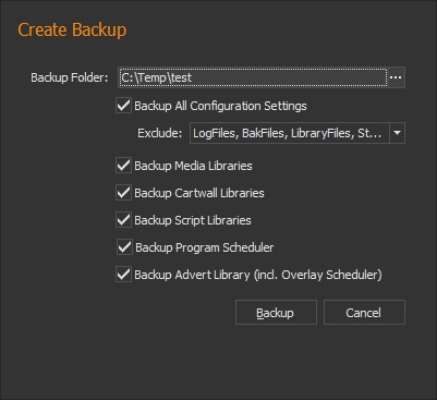

In addition you might want to create a backup of you your configuration files (which include the media library definition files).
Please see this post for additional info: http://www.proppfrexx.radio42.com/forum ... ?f=9&t=140
You can also use the 'Create Backup...' function from the 'Tools' ribbon tab:
