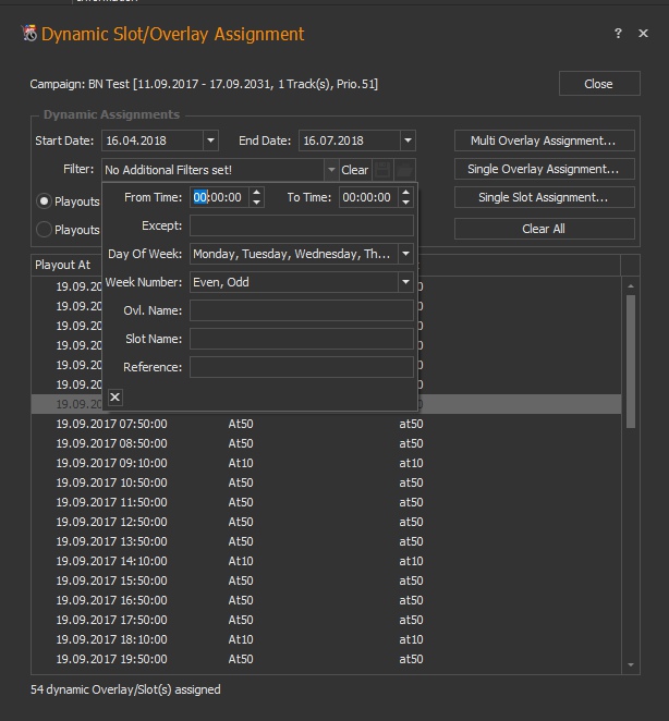

I am afraid I still do think we have a misunderstanding?!
Do you want to JUST define a date AND time when a campaign automatically expires (as written above)?
Or do you want to have more 'flexibility' when you assign a campaign to either a Slot/Overlay?
Note, that you can already do so within the 'Dynamic Slot/Overlay Assignment' dialog - just click on the 'Filter' combo-box.
Here you can also specify a start and end time to further limit the assignment:
