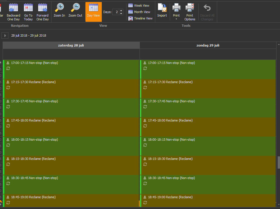

I did some test, and did the following, which seems to work.
Every hour divided into four parts of a quarter of an hour. the second and fourth part starts with advertising. See picture.
