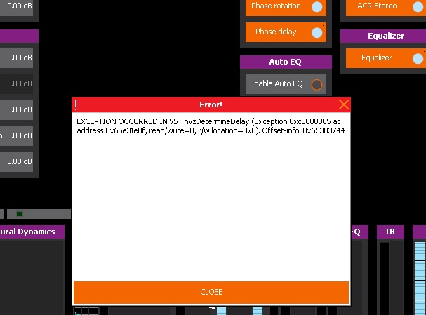

Now i have another problem. when i submit a VST plugin it gives a error see attached. I have submit it in the encoder settings off PF.
It was working this morning but now not anymore.

This is unfortunately not an error from ProppFrexx, but from the VST - so I am affraid you would need to ask that VST vendor about the error.
What VST is it? and are you using the right version, e.g. the 64-bit VST version?!

I have downloaded the VST plugin again a minute ago and now the error is gone. It is the 32-bit because i have the 32-bit version off PF. Now there is no sound going true the the VST (Stereotool). This morning it was working perfect and i didn't change a thing. I also have a license by the way..
