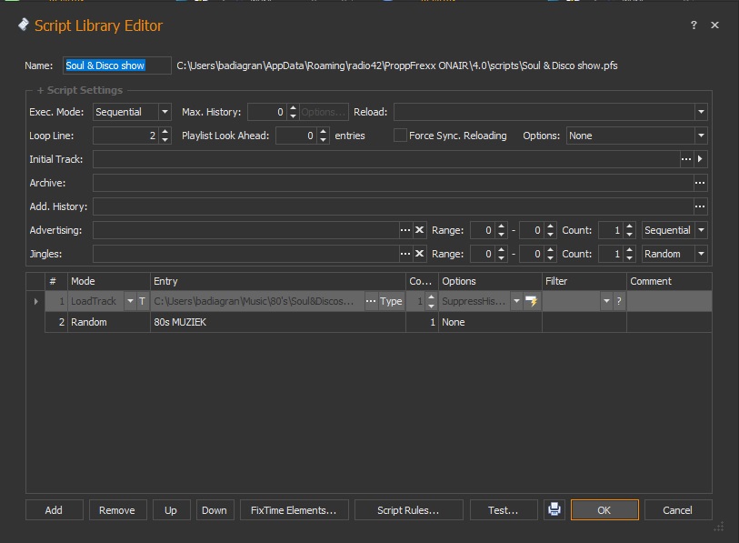

Re: Manual playlist scheduling
Yes, you need to write a small script with 2 script-lines for example:
1. line: Mode=LoadPlaylist, Entry=path-to-the-plalyist, Count=1, ...
2. line: Mode=Random, Entry=a-media-lib, Count=1
In the script options you specify LoopLine=2 (to prevent the 1. line to execute multiple times).
Now you can use this script to schedule your playlist within a program entry.

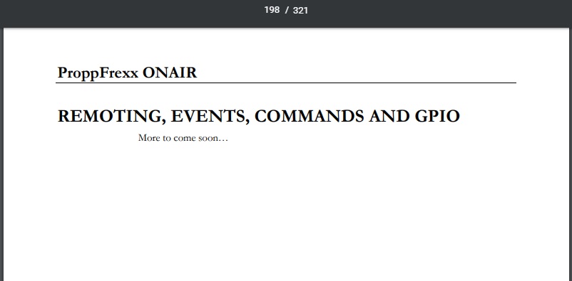

ok i understand that but how to schedule that mp3 file in the program-schedular? I have read the manual but there is no content yet by events and remoting...
Posts: 8347
I have tried to explain it above for Playlist.
It is the same for pre-recorded mp3 files, instead, that you use the "LoadTrack" script-line mode.
See here for more details:
viewtopic.php?f=9&t=10

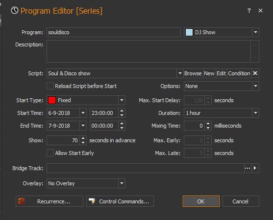

Posts: 8347
The script doesn't define the total length!
The Program-Scheduler entry does define the total length and than 'simply' executes the associated script.
Posts: 8347
Initially you wanted to schedule a pre-prepared playlist. Thus you used a script with a first script-line using the LoadPlaylist mode.
Now you wanted to schedule a pre-recorded show, ie. a mp3 file. For this case you use a similar script , but need to use the LoadTrack mode instead.
Please send me the script you are using and I can tell you what might be wrong.

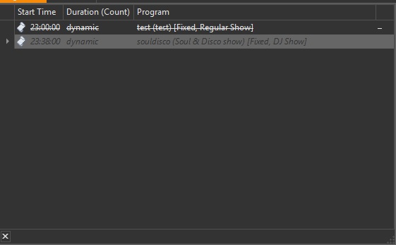

Radiofreak
Posts: 156
Joined: 26 Aug 2018 17:20
Post by Radiofreak »
see attached the script and scheduling.
