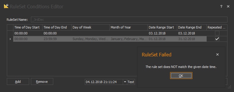

I have created a test setup on my laptop at home and I tested the new update but the problem isn't solved.
I noticed a test button in the ruleset conditions editor, and when I test a rule that shouldn't be active now,
propprexx says it matches the given date time.
As you can see I made a test rule that's active all day long, every day exept tuesday.
I made a second one that's active only on tuesday.
When I do the test in a script, it still picks jingles that don't mach the rules.

Perfect - that is also the right way... I am just preparing a v4.0.5.2 bug-fix release for you, which should fix the issue.

Are you sure you updated to the correct version?
I made the same test here and get a different result:
As you can see, here the same test reports, that the test failed.
Also my test script returned the correct tracks. So please test again.
However, please use the latest v4.0.5.3., as there was an issue with an obfuscation tool, which caused a startup error.

When the set hours don't match the current time, pf gives a "not match" notice indeed.
BUT : when the time matches but the day set doesn't match, it still gives a match.

Please see my screenshot above. There also the time matches, but the day doesn’t match. The result is failed.
What is wrong with this?
Maybe you did not pressed the tab button to leave the currently edited field - else the field edit isn’t committed yet.

I did the test again. Saved the rule. Re-opened it. Pressed test and still a match.
UPDATE : I did the same test now on our on-air pc and the same issue there with the latest version installed.
(only to be sure i could reproduce the problem on a second computer too)
