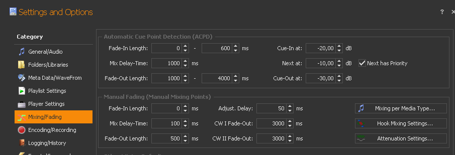

the ACPD settings
Posts: 8348
Re: mixer / fading settings
Here these work as expected. But you should note, that ACPD only works on tracks for which no cue-points have yet been defined!
It might also be, that you have already defined a mixer setting per media type. Once you defined a mixer setting per media type, the default mixer setting as in your screenshot will not be used anymore.

I was fully aware of the settings (also setting per by media type) but where I also changed something there was nothing to notice. After a restart it is automatically resolved. Now I wonder if I can remove the ACPD (if present) from existing MP3s at the same time.

Maybe you discovered the following:
Your audio files do not contain any cue-points.
As such, the first time an audio file from a lib is used, the ACPD is applied.
However, ProppFrexx keeps all meta data for all media lib related audio tracks within memory and cue-points are part of it.
Ie. when you now change some ACPD settings, they would only apply to files not having any cue-points. As such, the tracks already used are not considered again.
If that is the case you can simply clear the cue-points and do the calculation again as explained above (no need to save the TAG data persistently in that case).
