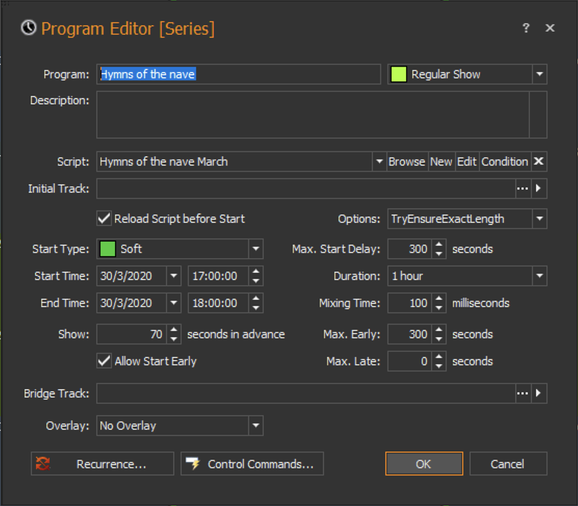

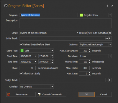

May I know why the scheduler sometimes doesn’t automatically play the next program?
This problem was observed over a few weeks, and happens on an irregular basis. Run scheduler is enabled, program settings same as other programs that has no issues. Screenshot of settings attached.

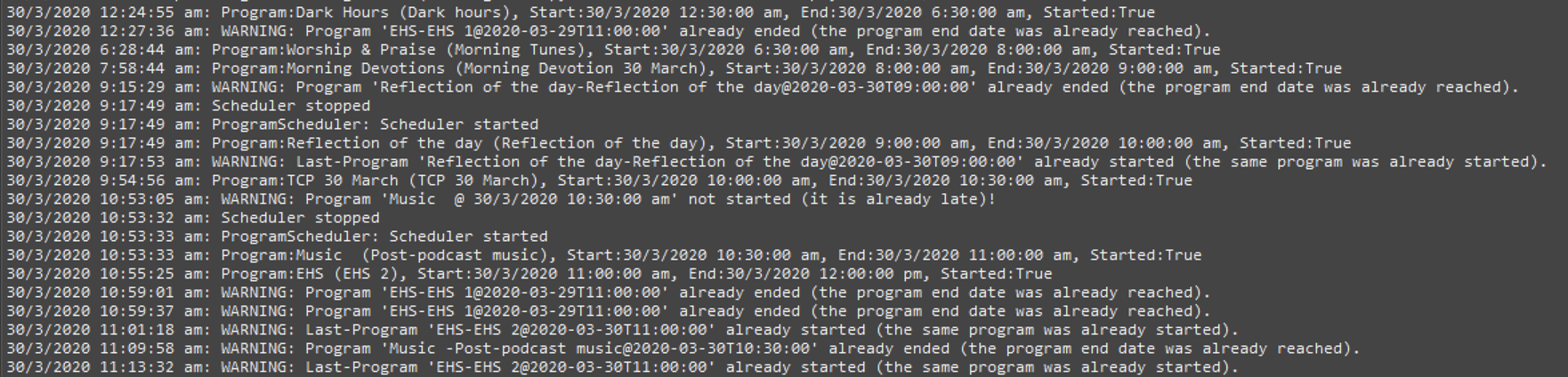

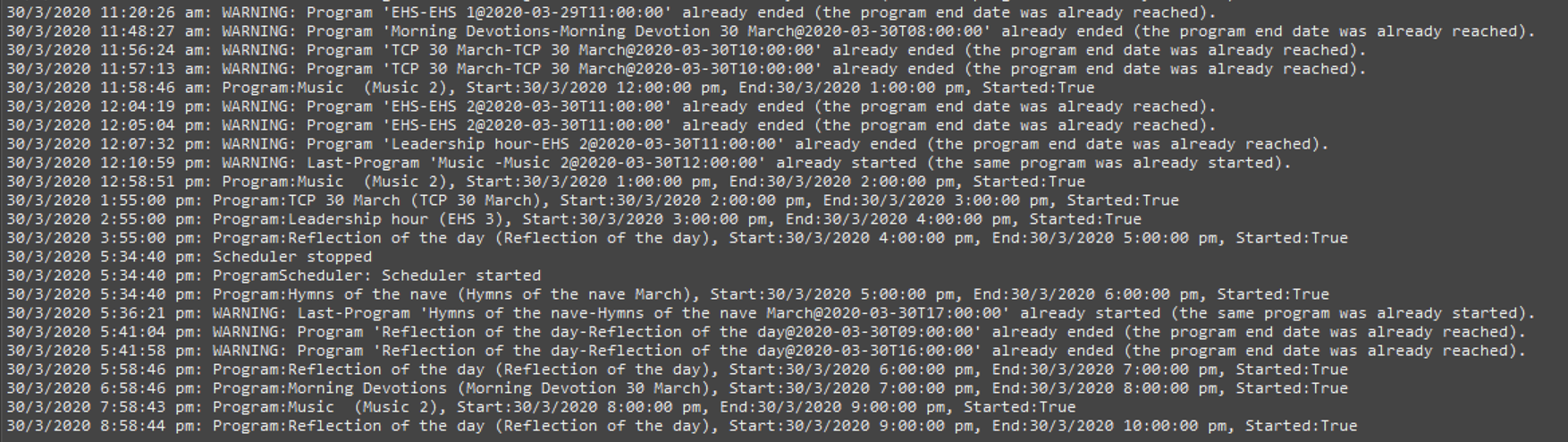

2 screenshots of scheduler log attached

Posts: 8321
Re: Scheduler hanging
Thanks. I couldn't notice your mail address related to any purchased license - do you mind telling me to which registration it belongs to?!
Further: Which of the programs didn't start correctly (related to the logs you posted)?!
I can see, that the a program "Reflection of the day" couldn't be started, because its end-date was already reached.
The program you indicated above ("Hymns of the nave") was actually started successfully in the logs you provided.

The "Hymns of the nave" program is scheduled to start at 5pm, but didn't. Manually started it at around 5:30pm.

Posts: 8321
In the Scheduler-Log there is no entry for "Hymns of the nave" at around 5pm - this means, that program was never triggered, as else you would have found an entry there.
Could it be, that you have defined multiple programs at the same time (overlapping).
Another question is than, what you have defined in the general settings, section Scripts/Scheduler - are you using the 'Continuous Mode'?
Or have you maybe defined a 'Condition' in the program entry itself.
