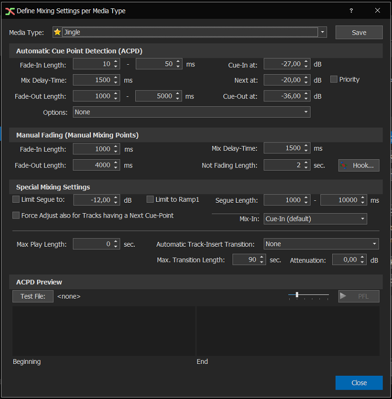

So look up the Media Type of those cartwall tracks and post a screenshot of the related settings.

I do not really understand what you mean. Here are the Mixing per Media Type settings for type Jingle. That's the type I've set in the cart wall library.
I suppose these are the default settings? I cannot remember having changed anything here. I did notice the Not fading length is 2 secs. Most tracks were just under 2 secs but I don't think that would cause the Next cue to be moved more to the beginning?
Anyway, I hope you can make anything of it.

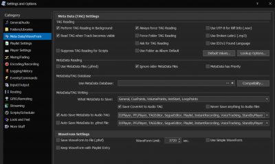

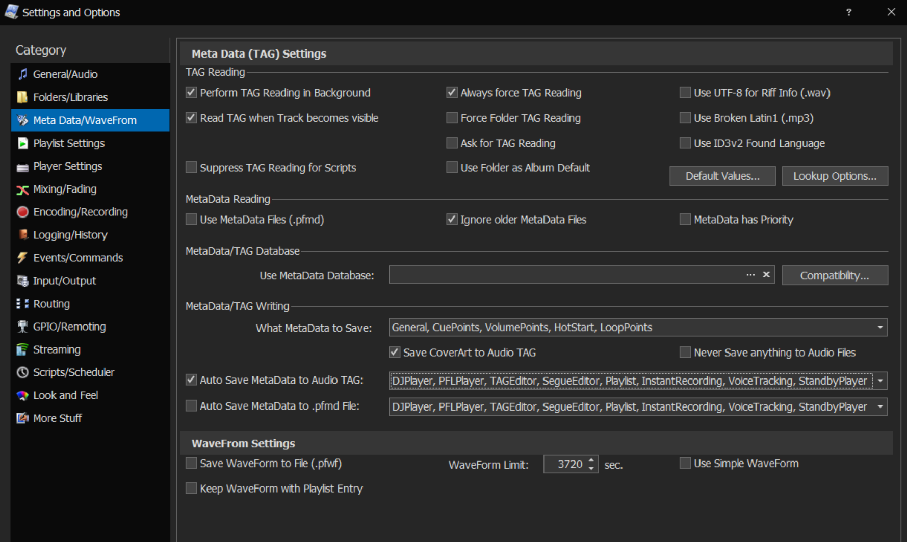

Perhaps I've found the cause... again...
I've had 'Auto Save MetaData to Audio Tag' enabled for (amongst others) the SegueEditor.
Since I heavily use the segue editor to move tracks around, this could have caused my cue points to be changed right?
I've now completely disabled this feature and are contemplating how I should let PFOA handle my meta data. Perhaps I should not store anything in the tags but use .pfmd-files instead? What are the recommended settings?
I'm affraid to change settings since I really cannot grasp the PFOA meta data concepts and lost so much time just trying to get this right. I love the program but this part is way to complicated for my simple brain... :(
Posts: 8348
Re: Where are CuePoints stored?
Yes that is correct. The Segue Editor would than save the TAG data automatically.
So you might safely disable that resp. only enable that for those elements where you for sure know that you want to do that.
I would not use .pfmd files, but always use the the TAG data.
Also note, that since the v4.2.2.0 you can now save the TAG data from all elements, eg. the cartwall or DJ Player...

Meta Data is (only) saved when:
- you have activated the 'Auto Save Meta Data to Audio TAG' and selected the related element (e.g. TAG Editor)
or
- you explicitly clicked on the 'Save Meta Data TAG' button
So as said above. I would not use .pfmd files but enable the 'Auto Save Meta Data to Audio TAG' for only those elements which you are sure you always want to automatically save the meta data to the audio's TAG data.
