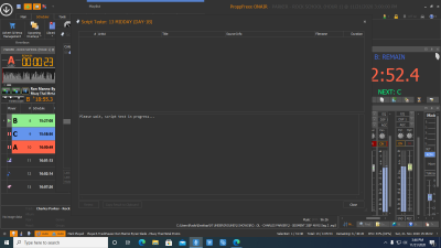

here is what i see on a test mode
Posts: 8350
Re: Question
Maybe cue points need to be read prior to executing the first script lines.
How long have you waited for a script test result? Just a minute or longer?
Maybe you can show your script and tell, how many tracks are contained in the media libs of the first lines used?

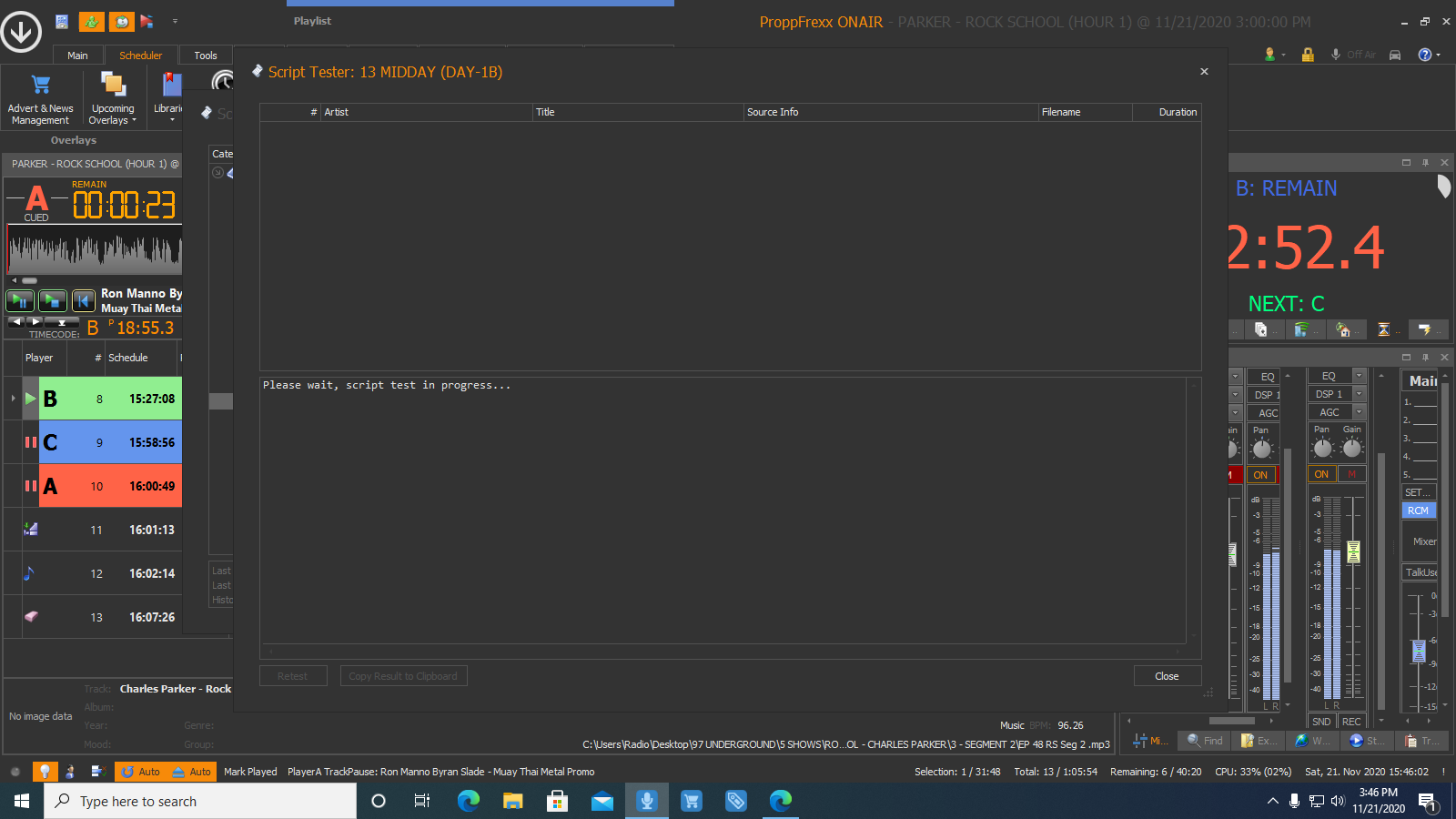

here it is
Posts: 8350
Re: Question
No, that doesn’t show your script and how it is configured!
And also doesn’t answer my other questions.
