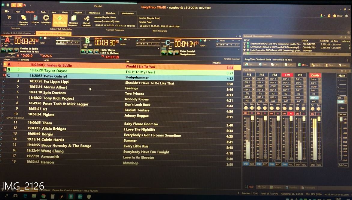

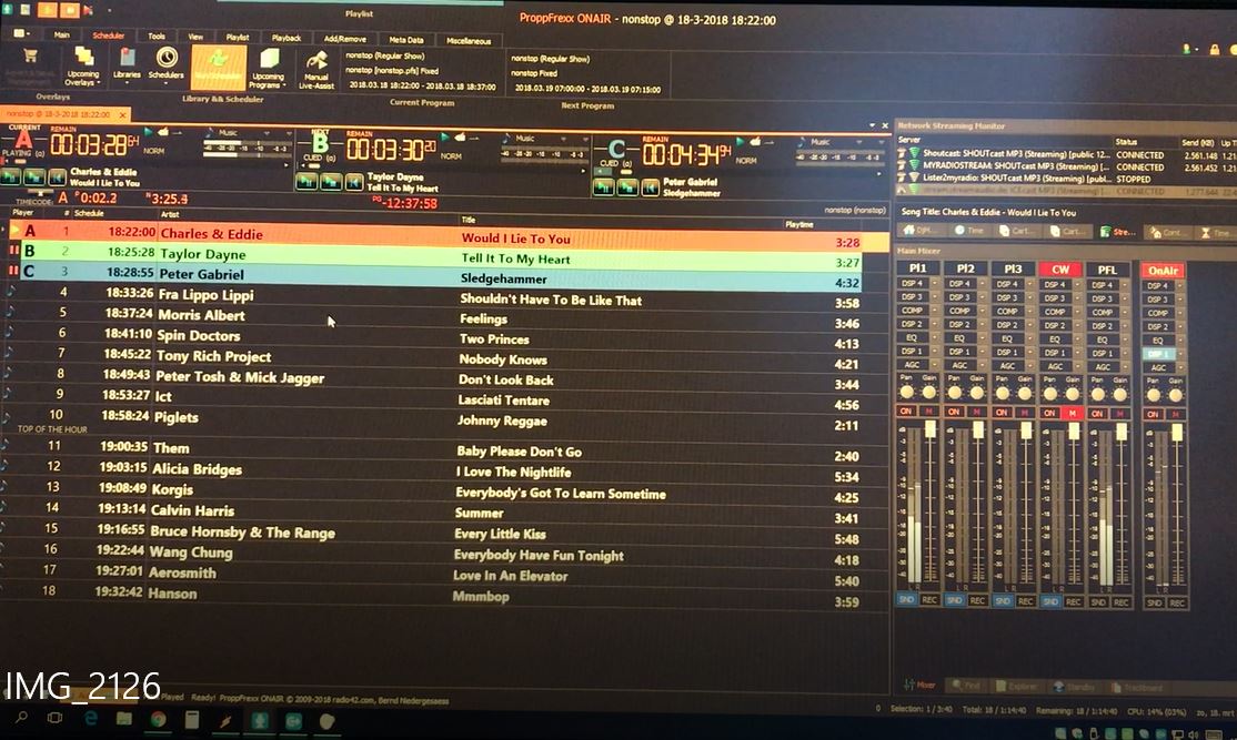

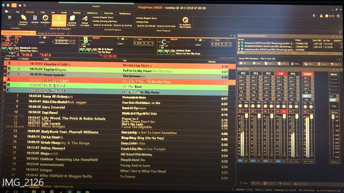

hello,
I'm going to try to explain what problem I'm experiencing. If a new program starts according to the scheduler while at that moment player A is active, then the music in the new program is the first song silent on ONAIR. See the attached files Knipsel1, 2 & 3 (I can not attach the video) for more clarity. I do not know if this problem has been present for a long time, it has only recently been noticed. So far I have no idea what to change.

From the images I can also not tell you what you are actually doing or what is causing your issue - or even better to say: what your exact issue is. However, it must be some setting issue, as I never have heard of a first track being silent and not on-air from any other customer.
But the top-most image looks totally strange! Looks like 6 players are marked/selected/loaded in one single playlist?!

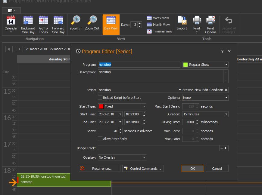

What exact ProppFrexx version are you using and how does your Program Scheduler entries look like?
Are you somehow using the 'Alternative Output Routing' or any other special settings? Any control-commands you are using/triggering with the programs?
You might also temporarily activate the 'Debug Logging' (see general settings, section 'More Stuff'). This writes a Debug_ .log file to your global log path (as configured in the section 'Logging/History'). Once you reproduced the issue, you might deactivate the 'Debug Logging' again and than send me the generated Debug_ .log file!
Please tell me exactly at what time and with which track the issue occurred then...

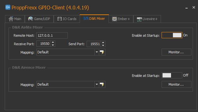

The only thing which seems to go wrong are all the EXEC_SEND_DRAIRLITE_... commands.
They probably go wrong because the GPIO Client is not connected?

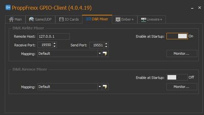

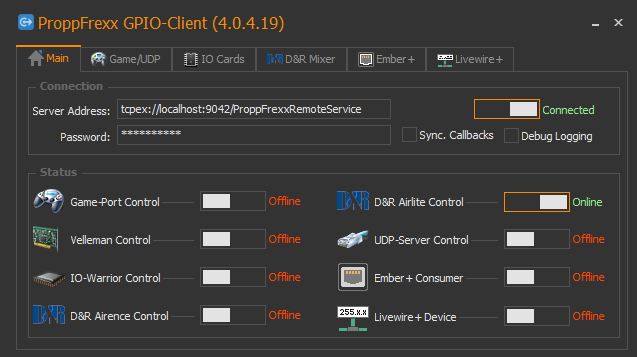

Did you activate the GPIO Extension Service (see the general settings, section 'GPIO/Remoting'). Once enabled a GPIO Client application will be started. And in that GPIO Client application you need to connect to your ProppFrexx ONAIR instane and then also enable your D&R Airlite service. Did you do that?

is connected
Posts: 8350
Re: start new program: first song no sound onair
Can you also post a screenshot from the 'Main' tab of that GPIO client?
Maybe your D&R mixer is not recognized? Or the client is not connected to ONAIR?

D & R mixer seems to work normally
