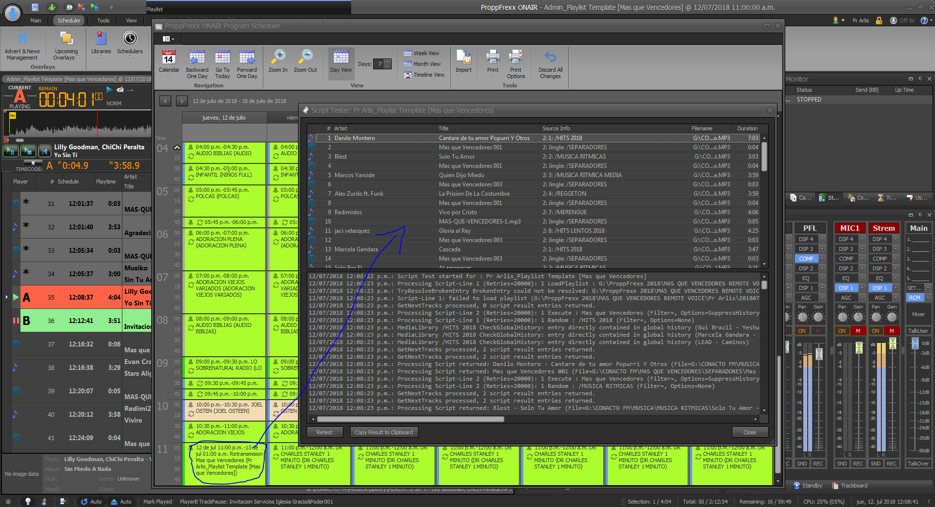

I would like to retransmit this Program from 11 AM to 11 PM
But When I Schedule from the Palylist That generates the Voice Track I load a different list to what I charge at 11 AM
How can I get back to Upload the same List that I charge at 11 AM?
Here is the File to show what I want to reload at another time

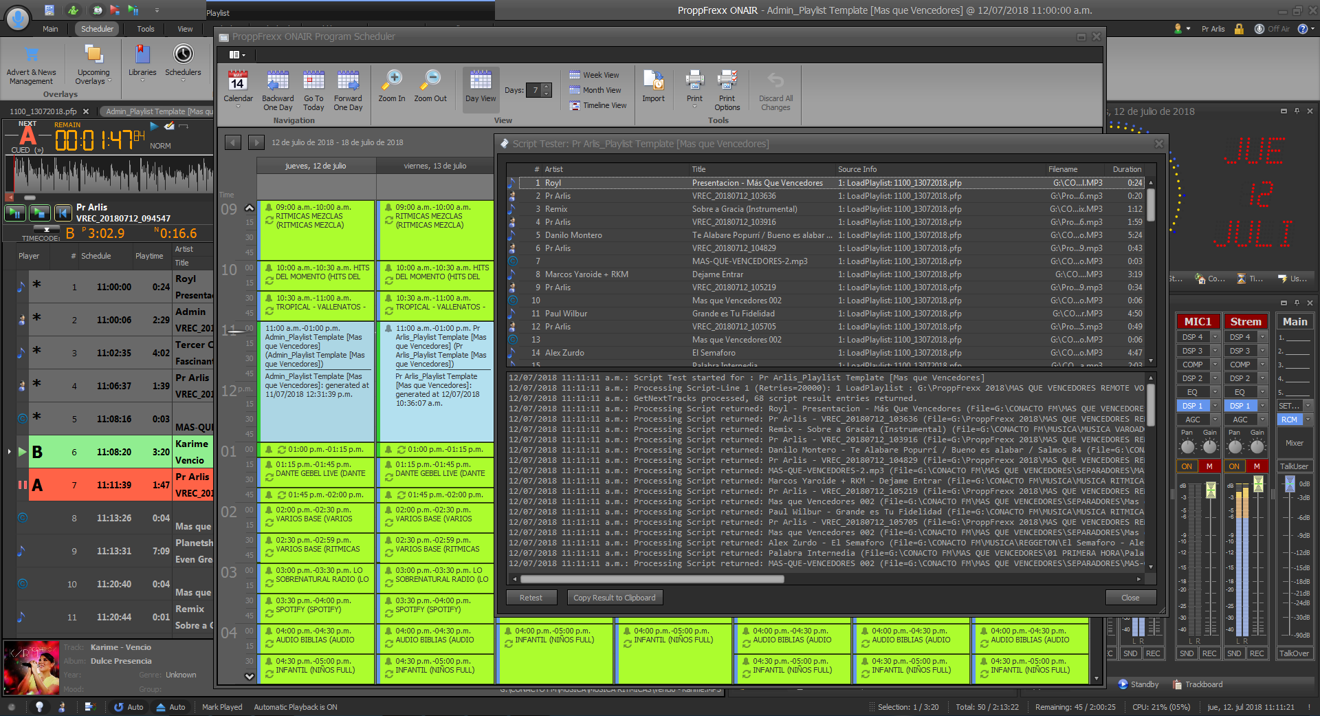

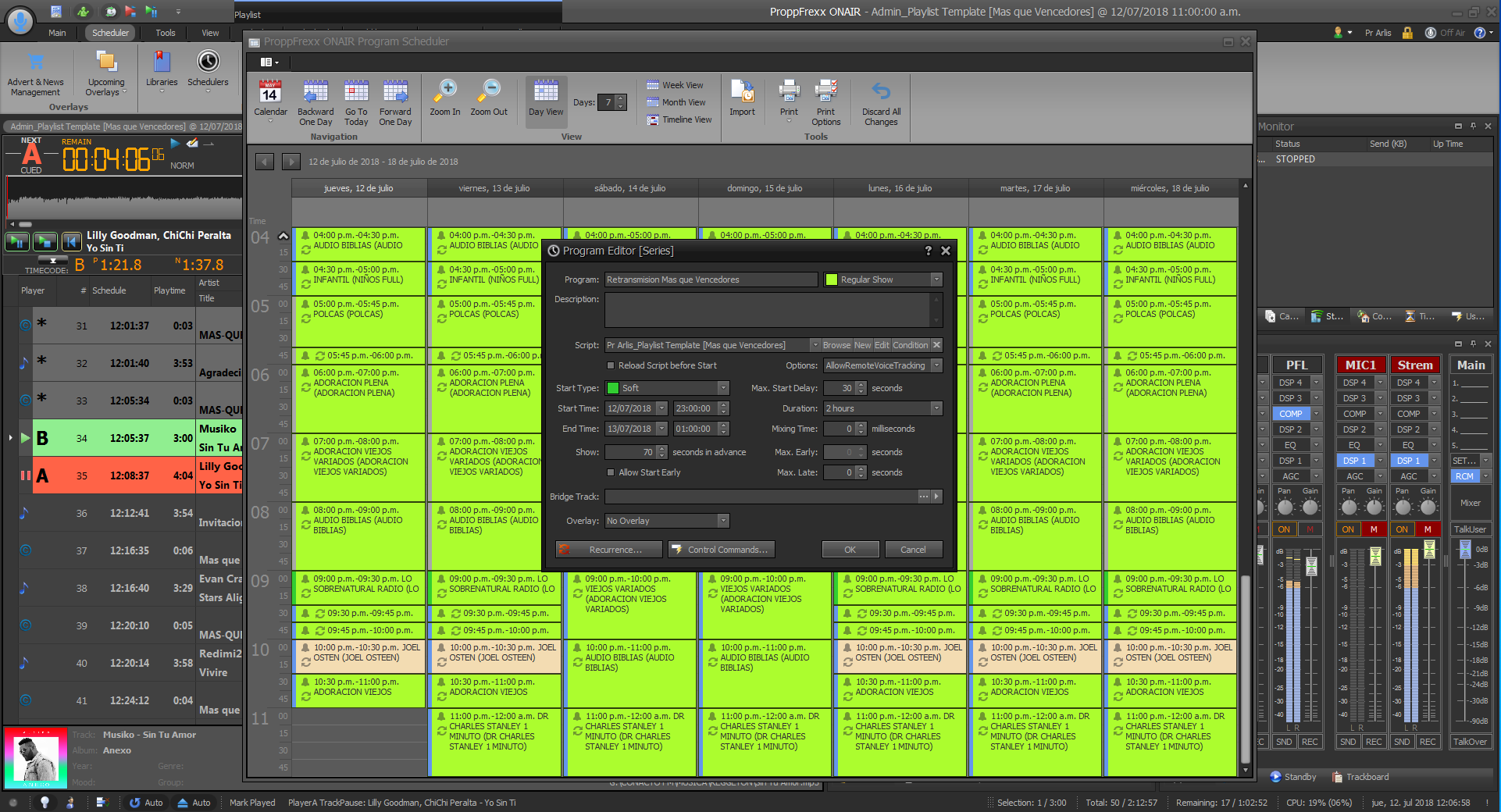

This is how I'm trying to prepare that block

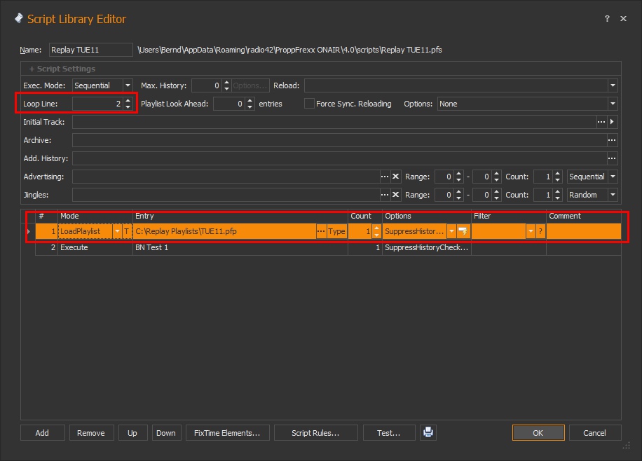

But you can specify in the original script a so called 'Archive', which will save all script-results to a playlist file:
In the picture below the file "C:\Replay Playlists\TUE11.pfp" (just an example name) will be created.
Now you can create a 2nd script (which you will schedule at 11PM in order to re-play that previously archived playlist.

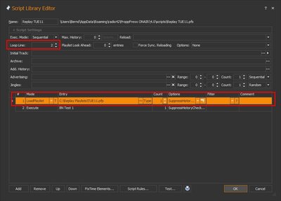

This script might look like this:
The attachment Replay Script.jpg is no longer available
The LoadPLaylist mode is used as the first script-line to load the previously archived playlist file.
Note the Loop-Line value of 2 in the script header to make sure, that this 1st line is only executed once!

In addition there is also an 'Option' for program scheduler entries:
SaveScheduledPlaylistFile: If checked, the scheduled and played entries are saved in a .pfp playlist file into the standard Recording Output Folder.
The naming of these playlist files is always: "yyyyMMdd_HHmm.pfp" - according to the start date and time of the related program.
This should also easily allow you to repeat a previously scheduled playlist.
In order to do so, you might create a script with a 'LoadPlaylist' script-line (just like above!).
In the entry of such 'LoadPlaylist' script-line you might use the ${start_yyyy}, ${start_MM}, ... etc. macros!
