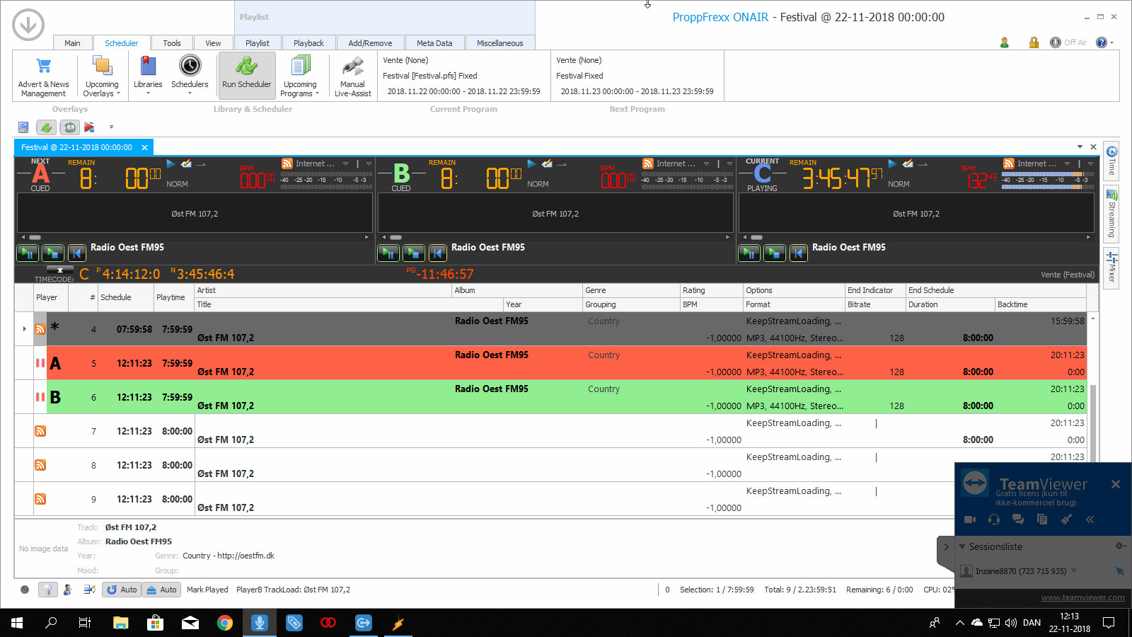

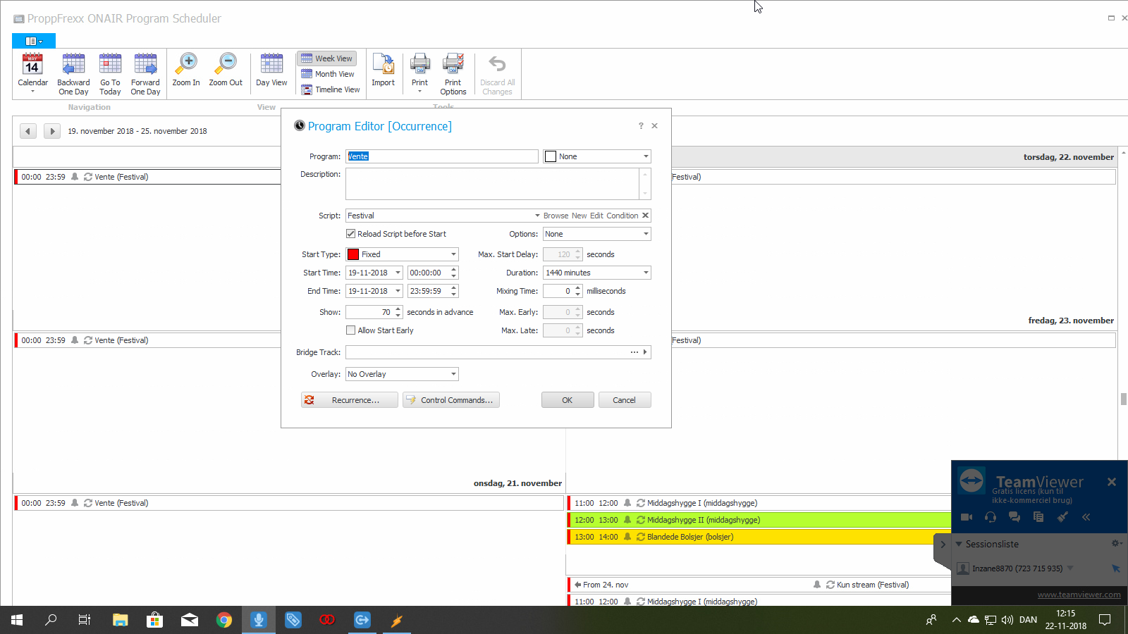

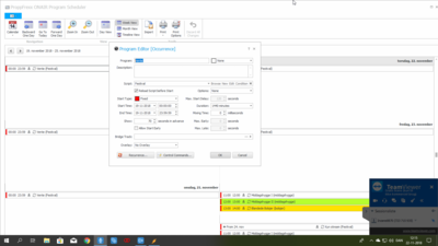

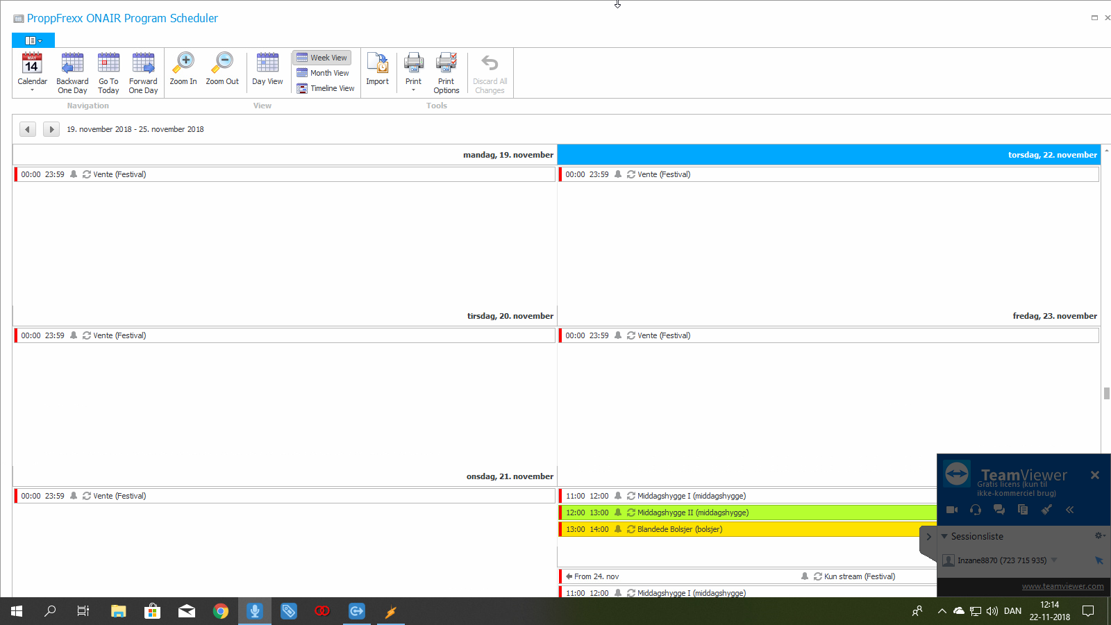

Also I took screenshot of MAIN window, Scheduler and "Restream-ocurence" (Also attached)

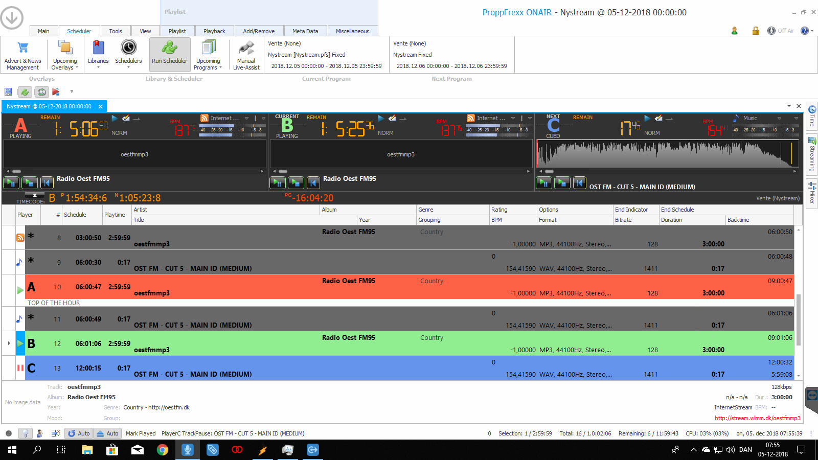

Finally I got back to the office.. The "2 line script" has not made any "massive lines in playlist". And playing a jingle/stationID is also fine. Though sometimes (in fact many times) PF is playing/starting 2 players restreaming (giving an echo) See picture.
Im thinking: would a "control command" (stopping other players) be a solution?
