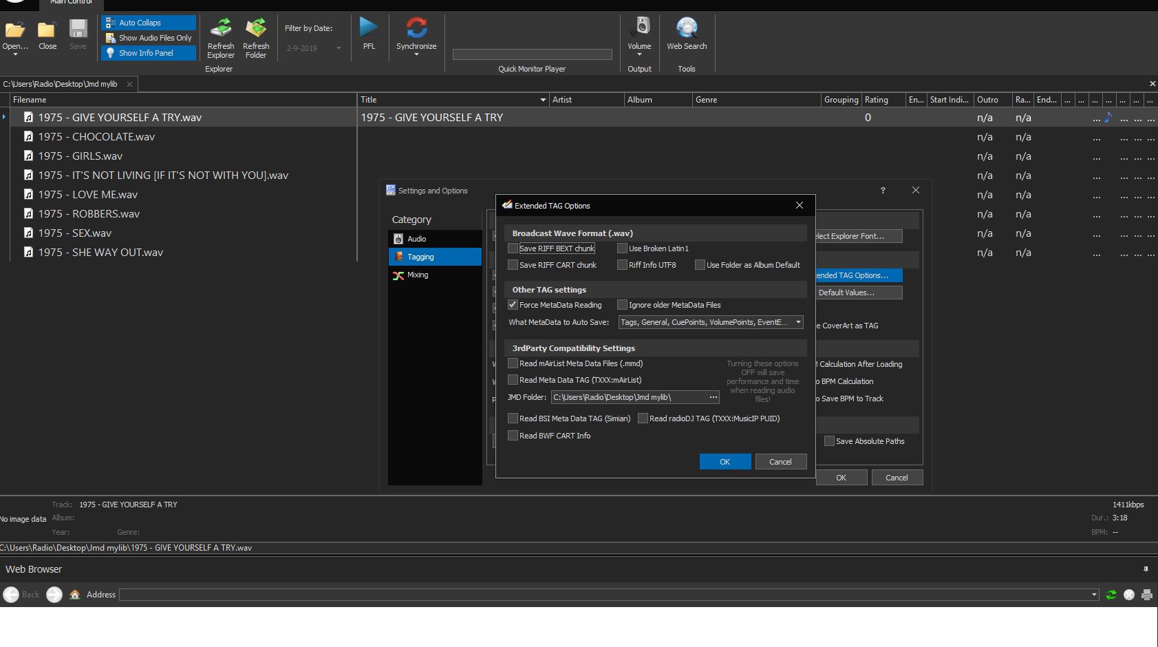

- I have Wav files completely empty (No RIFF content or whatever)
- I have JMD files for these wave files
Here are 3 test wav incl JMD https://fromsmash.com/Jmd-files (to big for this forum upload)
JMD gives no result. Maybe my config isn't wright or a bug or....
Config see attachement

Ahh, now I see the issue!
It will be fixed in the next release!

Please check the new v4.2.0.3-Update it now optimized the MMD and JMD meta data reading!
I hope with this update all your needs are satisfied.
