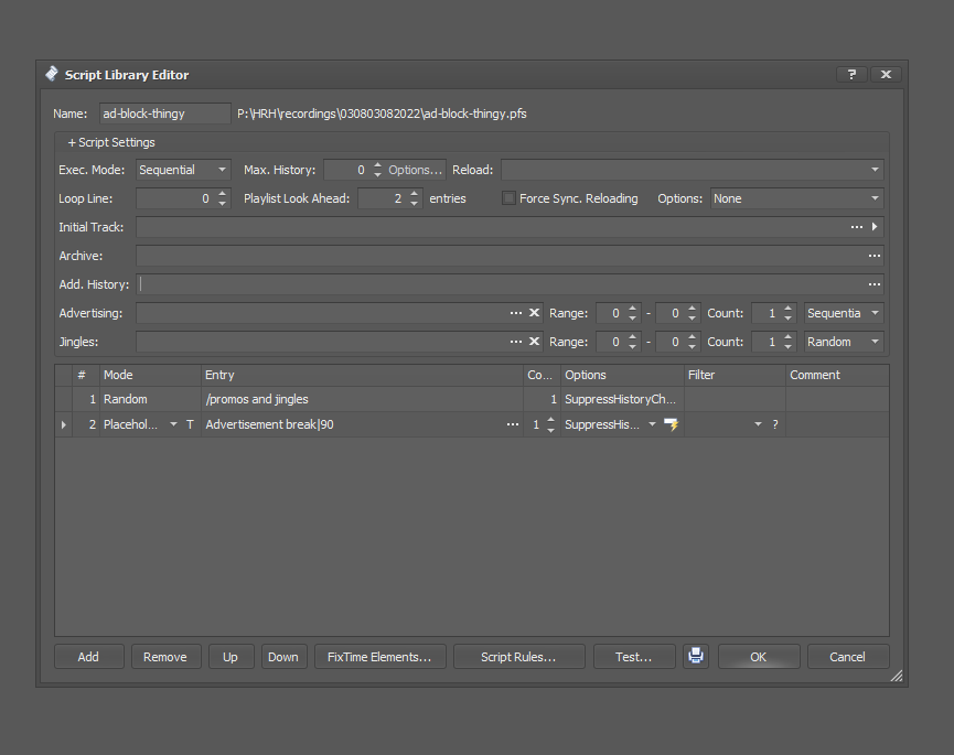

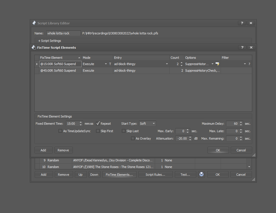

i tried that. created a sequential script that would pick a random track from the jingles library then a placeholder, however when tested in a template it would return a jingle in the first qquarter passt option and a placeholder in the quarter past of the next hour. how do i make it return both at the same time?

radio42 wrote: 07 Aug 2022 15:58 Can you show me your FTE definition? Eg. a screenshot.
Ie. in your ‚Execute‘ mode script-line you would need to specify Count=2. In that case it should return 2 elements from the given script.
But I have never tested it that way, as I don’t understand the reason for returning a placeholder as a FTE.

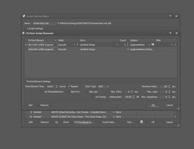

I wull test when I return from my holiday next week, but the execute, count=2 should actually return 2 entries and not only 1. I also don’t see any difference in the first 3 images you posted. Any reason?

radio42 wrote: 07 Aug 2022 17:59 I wull test when I return from my holiday next week, but the execute, count=2 should actually return 2 entries and not only 1. I also don’t see any difference in the first 3 images you posted. Any reason?
But if you are trying to use adverts as FTEs, I suggest using Overlays instead!
because i only posted two. for some reason it trebled one up.

Re: adding two items together in the fixed time elements of a script
I just looked at your post, it has three of the same inline images (so it did not somehow added more, but very obviously) :-)
