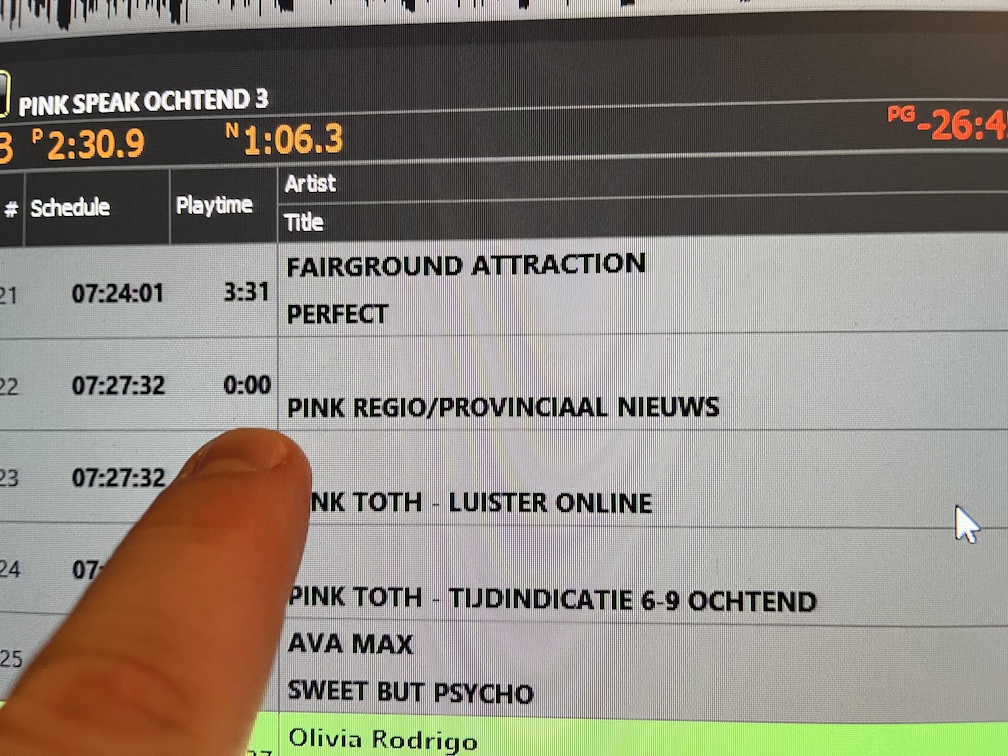

Once in a while i have PF skiping certain (mp3 files/talks). The files are prerecorded and fixed in the playlist. When PF loads the playlist the files are added with timing but when it's time to play the file PF just skips the file (changes the timing to 00:00) and goes on to the next file. Anyone who has this error also or know how to solve it?

Thanks for your quick reply! So the only rule I use for these files (added in the playlist as 'loadtrack') is 'Supress History Check' and 'Supress Add History'. No other rules also no script rules added. With fixed in the playlist i meant added as loadtrack. No timings or anything added. Playlist via this link; https://wetransfer.com/downloads/be9cc4 ... 744/08f37b

So i have done everything you asked and also changed the link/path to the file to the normal c:/ drive and still PF is skipping files. Any other ideas? Tips? I have nothing else running on this machine exept from PF, McAfee (virusscan), Windows Security, Qsync and Anydesk. The system is not running any other software or operation.
