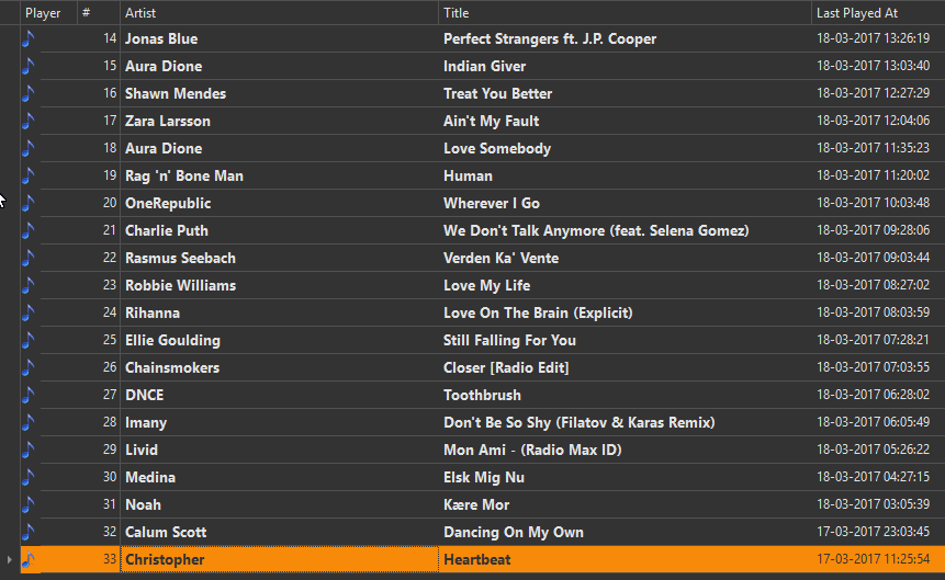

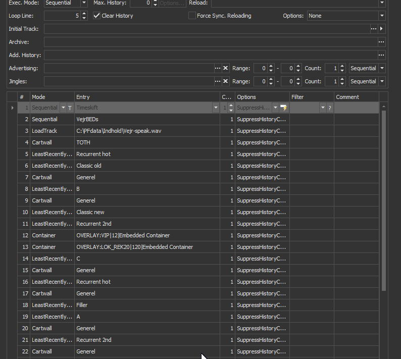

Hi. I use the LeastRecentlyPlayed in the script for my songs, and SuppressHistoryCheck. Then I keep my songs in playlists: A rotation, B, C, Hot recurrent and so on.
Most of the time this is fine, but I had a 2nd recurrent playing every two hours, which was not fine. I had to delete the song.
But now to my question: In the screenshot it's almost perfect with two plays every hour, but the two songs in the bottom are "forgotten".
What could be the problem?
Thank you!
Thank you!

Re: "Forgotten" songs
I mean that PF should play a track "from the top of the playlist" and then put it at the bottom, just like in the old days with a CD the top of a playlist, that is then placed at the bottom. If PF played the songs in my playlist evenly, the song Heartbeat should be played at 2AM this morning, but it was played yesterday at 11AM
That means that other songs are repeated more often
(Sorry for my bad English, hope you understand)
Ok, I could try Sequential and see how that works out for my music flow. But in my example, Christopher - Heartbeat is "the least recently" played song.
Why does PF ignore that song two times every hour for half a day?
Thank you
Thank you
It is used two times every hour, and 33 songs are in the category. That means that after about 16 hours, we should have played all the songs.
Until now we have only used dynamic generated playlists.
Right now it is Shawn Mendes, Treat you better that is at the bottom, and still hasn't been played after 24 hours.
Script is attached (the rest of the lines you can't see is the same type of song-settings)
When the media lib contains only 33 tracks and it is used to schedule 16 hours of music, then probably all tracks are played on the same day.
Again, as explained above, the 'LastRecentlyPlayed' mode picks a random track from all tracks having the same age in 'days'!
Eg. If all your tracks are almost played within a single day, this is almost equal to the ordinary 'Random' mode - which might repeat tracks more often. In that case try the 'LastTimesPlayed' mode, which uses the Play Count instead of the last played day.
