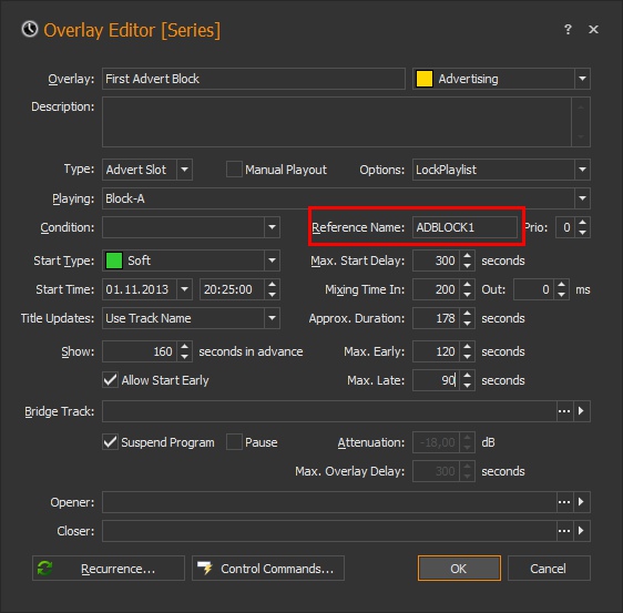

Please check if I understand, if I have 2 commercials breaks on 1 hour it should be like this:
**Asign the command**
AD BREAK 1 at 00:25 : OVERLAY:<ADBLOCK1>
AD BREAK 2 00:45 : OVERLAY:<ADBLOCK2>
And then create 2 overlays per hour with the name of OVERLAY:<ADBLOCK1> and OVERLAY:<ADBLOCK2>:
Settings of the overlay:
- Type: AdvertSlot
- Start Type: Fixed
- Start Time: 00:25
Re: Create Ad Block with External Music Scheduler
No, the name of the overlay can be whatever you like, but the 'Refecence Name' should be 'ADBLOCK1' resp. 'ADBLOCK2'.
Just as shown in the picture below:
