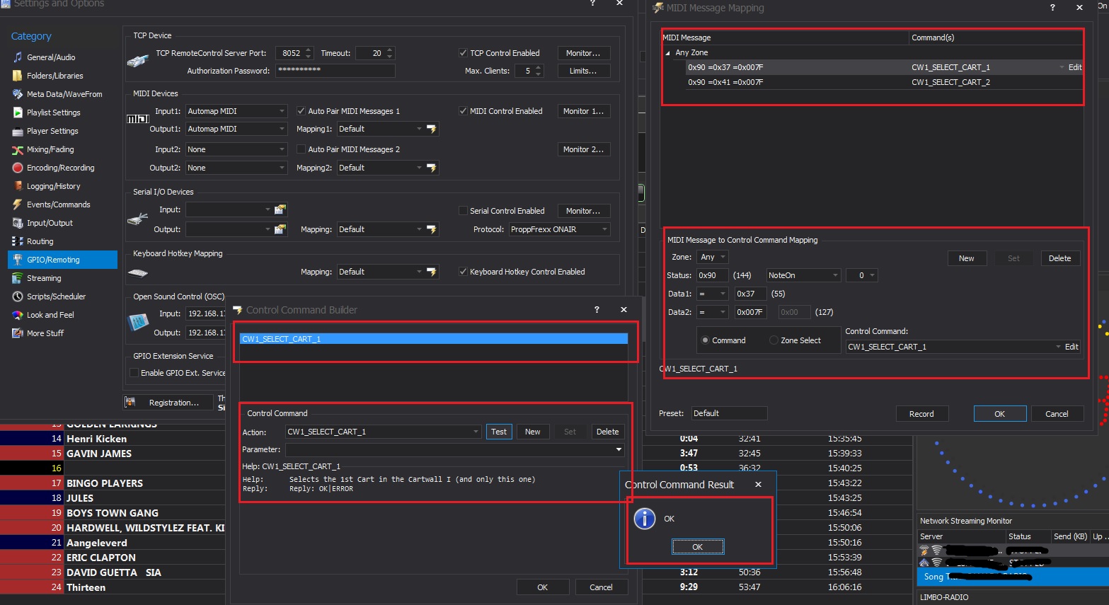

Post by Bumperke »
radio42 wrote: 02 Oct 2018 09:45 To steer the cartel you simply need to map the Midi message to one of the CW1_*** resp. CW2_*** control-Commands.
You should think that:)
It shows this, is there something wrong, did i overlooked something?
Will
Posts: 8341
Re: Novation launchpad
Maybe this post will explain all your missing info:
viewtopic.php?f=9&t=22
However, it is bit of MIDi Basics required in order to perform the correct mapping.
Sometimes you need to disable the ‚Automatic Pair Midi message‘ option In order to get it working.
Some controller sometimes use a special Midi mode, which also needs to be toggled. But all that heavily depends on the interface of the Midi controller and I can of course not help and know all Midi controllers on the market.
So I guess you simply need to experiment a bit.
But I know, that a few user are also using the Novation Pad, so i am pretty sure it works fine.
Posts: 8341
Not sure what you want to achieve.
But the SELECT command just selects the cart.
Use the related PLAY command to start its playback.
See the user manual for a complete list of all control-commands with a description.
Bumperke
Posts: 243
Joined: 21 Nov 2016 09:31
Post by Bumperke »
radio42 wrote: 02 Oct 2018 14:05 Use the related PLAY command to start its playback.
Stupid me, haaha. Fixed
