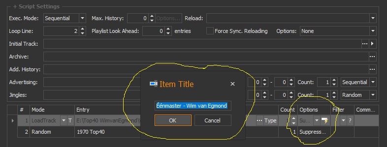

I have every friday a 2 hour disco show with 4 MP3's every hour. This files i get from a FTP server with every week the same name so every thing is going autmatic. In my script i have in every line "SupressSongTitleUpdate". On the left site by "T" i have give the first line a different name.
Now the question is why does Proppfrexx not pass this on as metadata?
Thanks in advance

Probably because you used the SuppressSongTitleUpdate option ;-)
As this name suggest it suppress it.
Just remove that option and only use the T button to set an alternative song title manually. That should work.

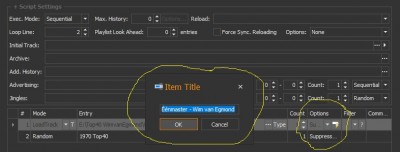

Has you can see i have written by 'T' a name for this file/line. By options i have left SuppressTitleUpdate. Now the name is not comming up in the metadata.

@Radiofreak: as written above, you need to remove the SuppressSongTitleUpdate option!
So please set the option to None and try again.

Thats the the point. I have removed the option suppresstitleupdate. There is no title coming true att all. Only this sign: -
Posts: 8295
Re: Metadata
That’s more than strange.
In the above Image it was still present.
To what have you set your song title update format in your streaming server configuration within ProppFrexx?

What you see in the above image that is SuppressHistoryCheck what is unnecessary, i know! But when i remove everything it still dosn't work.
I have set: ${artist} - ${title}
Posts: 8295
Re: Metadata
Can you try: ${trackname}
