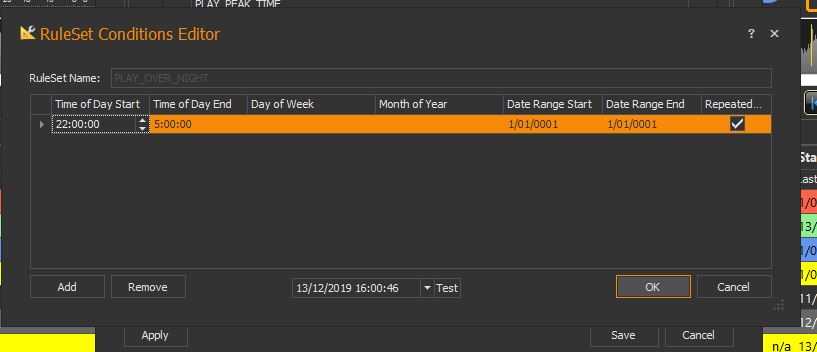

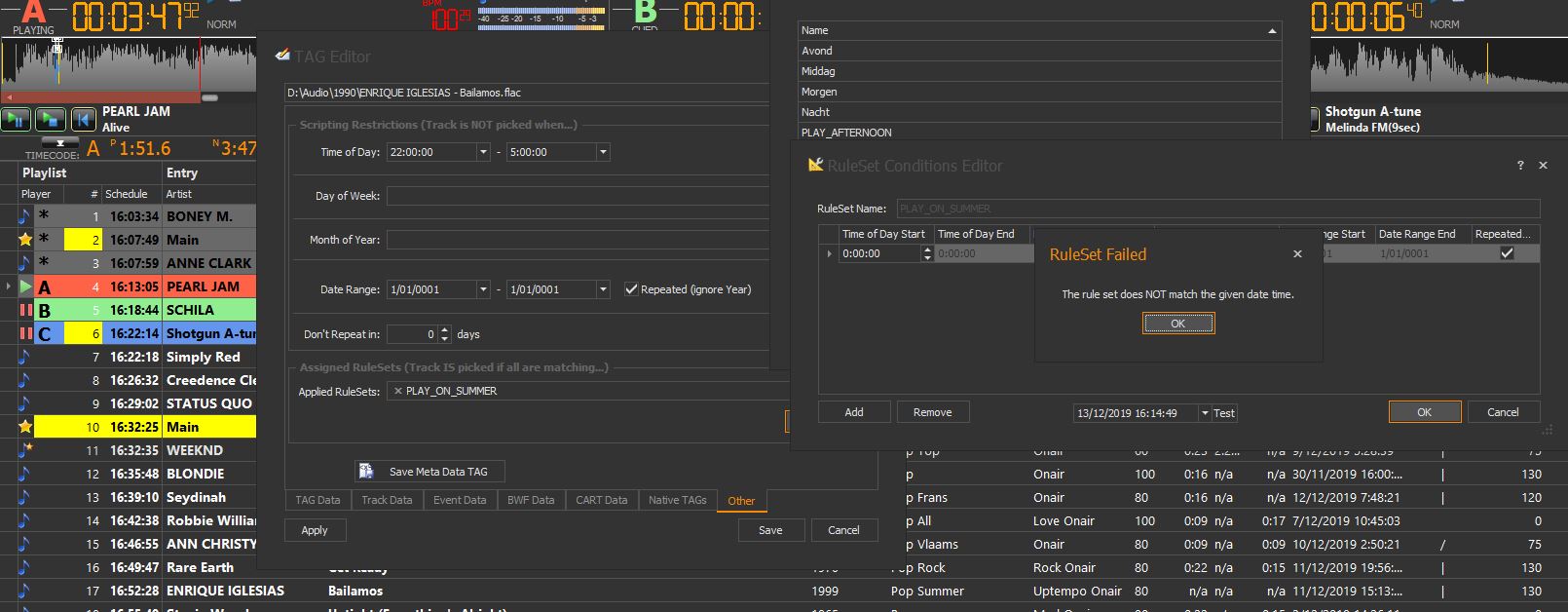

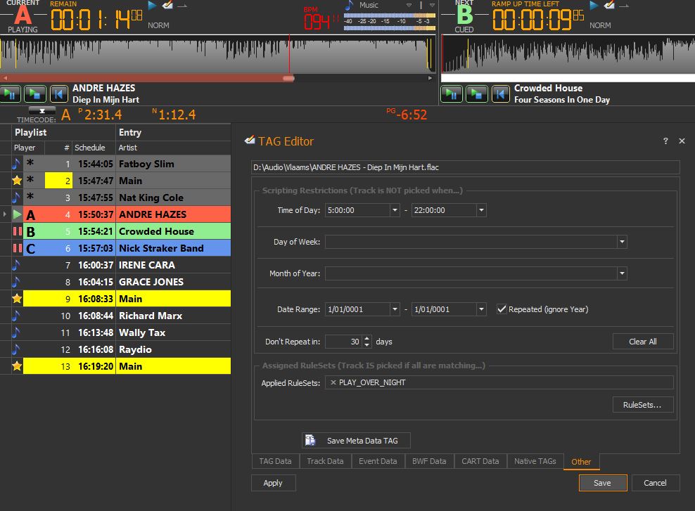

What is wrong here. The file is tagged so that he can play just overnight. Yet he played during the day. See screenprint.

How was the track added to the playlist? Via a script or maually?
If via a script, do you mind showing me the script resp. send me the related .pfs script file?
I do not understand your last screenshot, as a time range from 0:00:00 to 0:00:00 wouldn't make sense.

It looks like you are using the 'UseLastTrackOnFinalFail' script option. Plus you have various histories in use and a filter per script-line.
As such, I assume, that for a particular script-line no track was effectively matching the history checks an the restrictions.
As such, the UseLastTrackOnFinalFail option took place and the last used/tested track was used - which then of course violates a rule.

That is the option you have already set. As said, it’s use means, that a script-line is not skipped, but instead the last tested Trackboard used (after all other tracks have been tried).
Use the ‚Test...‘ function to see what History might be reduced.
