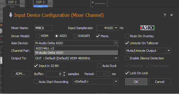

Then I choose the mic in the main mixer in proppfrexx, and go to the "input device" and mine is Line 1/2.
And now I have only a mono sound only the left side?, and a huge delay?

One option is to double-click on your mixer input channel name to open the configuration dialog and select the 'Mono' option checkbox!
If that is not working (due a possible restriction of your sound card driver) and to still regulate this shortcoming and to duplicate the incoming mono signal to both channels of the input mixer - make a right click on the name of the related mixer input channel and select from its context menu the 'Processing' entry and select 'Standard Mono'.

Once installed go back to you mixer input channel configuration dialog and select ASIO as the driver model.
Important Note: It is recommended to NOT mix the driver models of your sound card!
I.e. you must also switch all other mixer input AND output channel to ASIO to achieve real low latency audio processing!

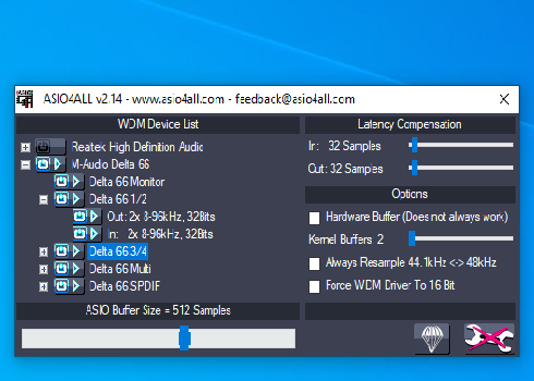

If your sound card doesn't come with an ASIO driver, you might try a generic ASIO driver: http://www.asio4all.org/

Else (as said) try the Asio4All driver.

i know it is already installed, and also the Asiodriver.

Note, that ASIO is exclusive, ie. it can not be used twice with another application in parallel. Are you maybe doing that?
Have you changed ProppFrexx mixer channels accordingly? Did the ASIO drivers show up, when you select the ASIO driver model?
You might need to restart ProppFrexx once you installed asio4all.

When i choose for "M-audio Delta Asio" i have sound but with a very great delay?!
When i choose for "Asio4All v2" i have no sound?

Then try to set a Buffer value (below in the dialog) eg. 512 or 256 samples (when using the Delta ASIO driver)?!
If Asio4 All doesn’t work it is not properly configured, resp. It conflicts with the Delta ASIO driver. As said only one can be used at a time. You might need to stop ProppFrexx before configuring it.
