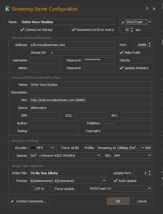

Please show your streaming server configuration of ProppFrexx (eg. a screenshot).
And indicate if it is SHOUTcast v1 or v2 Server you are trying to connect to.

Thank you for your response. Enclosed please find an attachment of my server configuration.
The parameters are as follows:
Address / Host: s28.myradiostream.com
Stream Port: 26886
Streaming version: SHOUTcast v1
As I mentioned, I successfully connect to the server using winamp with shoutcast dsp using the same settings.
Kindly
Richard

I don't immediately see anything wrong.
-sc_serv.exe started up?
-password correct?
-encoder setting: Source correct?

But I do ;-)
You need to leave the field 'Stream ID' empty! As otherwise the SHOUTcast v2 protocol is used.
Click on the '?' icon at the very top right to get further help for each option.
