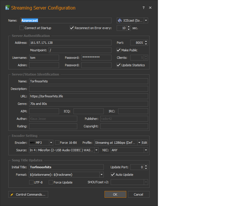

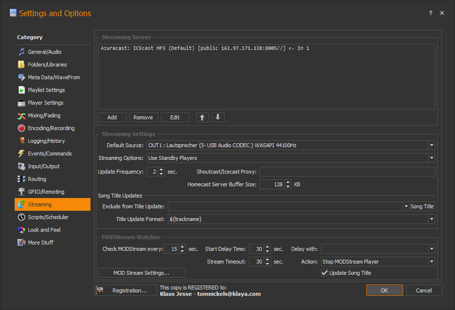

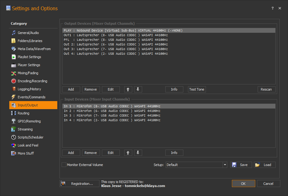

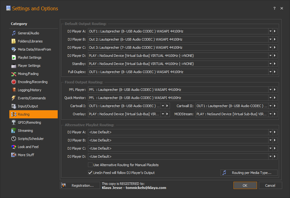

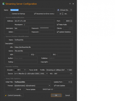

Ok, I am running 3 external soundcards (USB 5,6,7) connected to Player1 (5), 2 (6) and 3 (7) going into Behringer DX 2000 USB. Soundcard #4 (USB 8) comes from my behringer DX 2000 usb. Every channel works fine so far. I am streaming the signal to an external azuracast and azuracast is sending it to laut.fm. Works like a charme with mairlist (just to find out where the problem is). Enclosed some screenshots

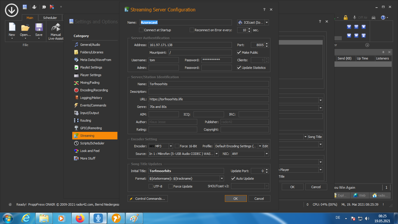

Meanwhile I figured out, it is not the streaming setup since I am able to stream without any problems via Propp Frexx using an external player. As soon as I am using one of the internal players A, B or C it starts playing fast or slow but not normal and steady.

In your setup it looks like you stream from a mixer input channel (In 1). That seems to also route its out out to the OUT1 output channel - which is used twice also for PFL? That looks strange to me.
What do your heat in OUT1 resp. PFL? The same audio? Are using the Output To feature in your In 1 mixer input channel?
Is PFL or OUT1 also slowing down when you hear it?
It somehow looks like a mixer setup error?!

Alright, I fixed the mixer output thing but it is still not working. So my setup is very simple. Channel A, B and C of the Behringer mixer goes to players A, B and C via seperate external soundcards which is USB 8,6 and 7. USB 2 is the USB channel of the Behringer Mixer (Main output). So the idea was to stream that USB 2 which works but still that speed thing. New screenshots enclosed.
