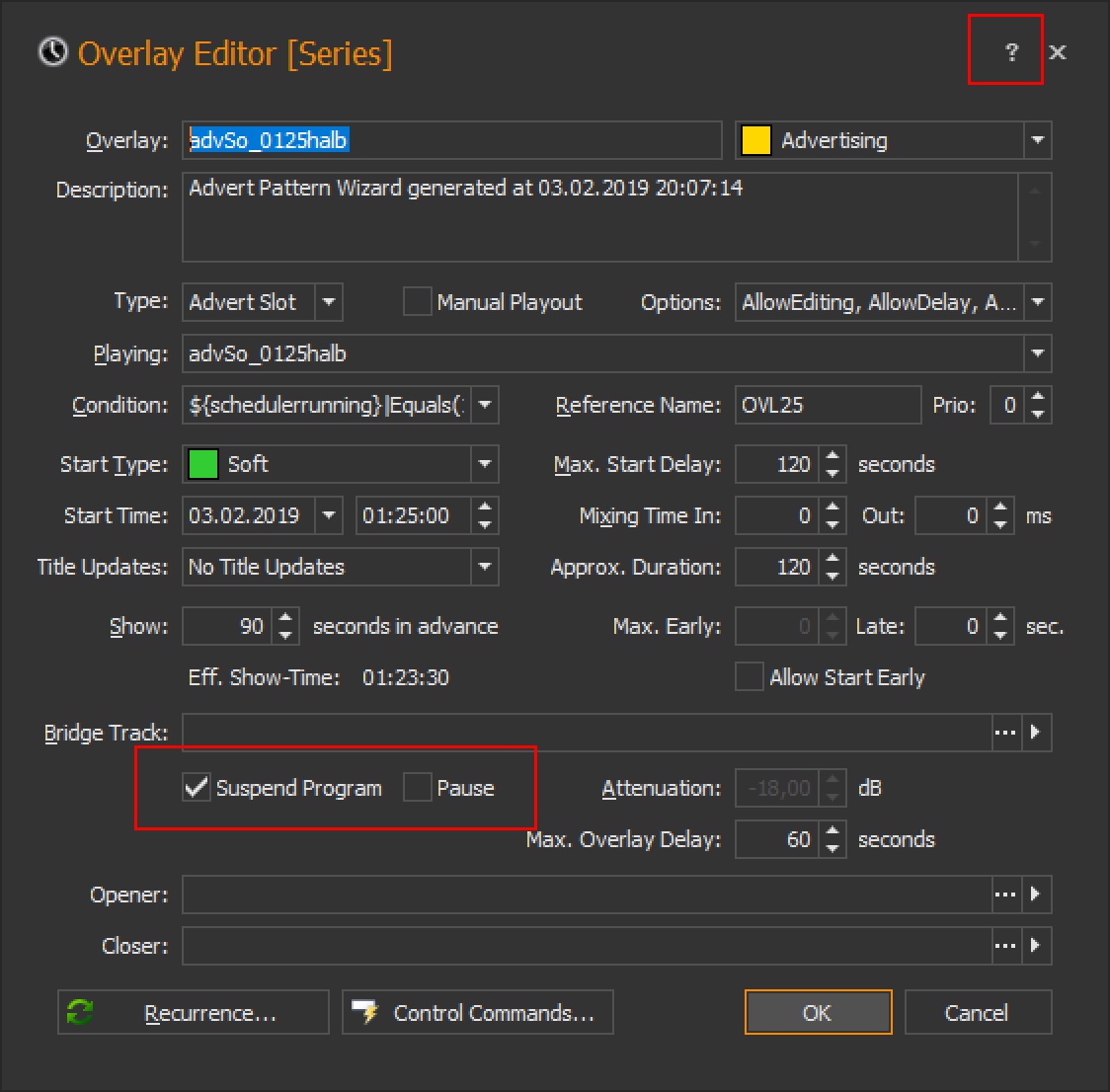

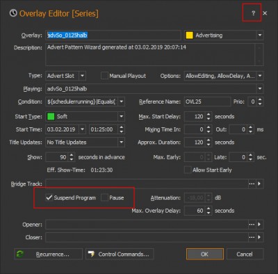

Posts: 8349
Re: Playing 1 hour file with ads
Here comes the screenshot. Open the Overlay Editor from within the Overlay Schedler. Click on the '?' icon to get more help...

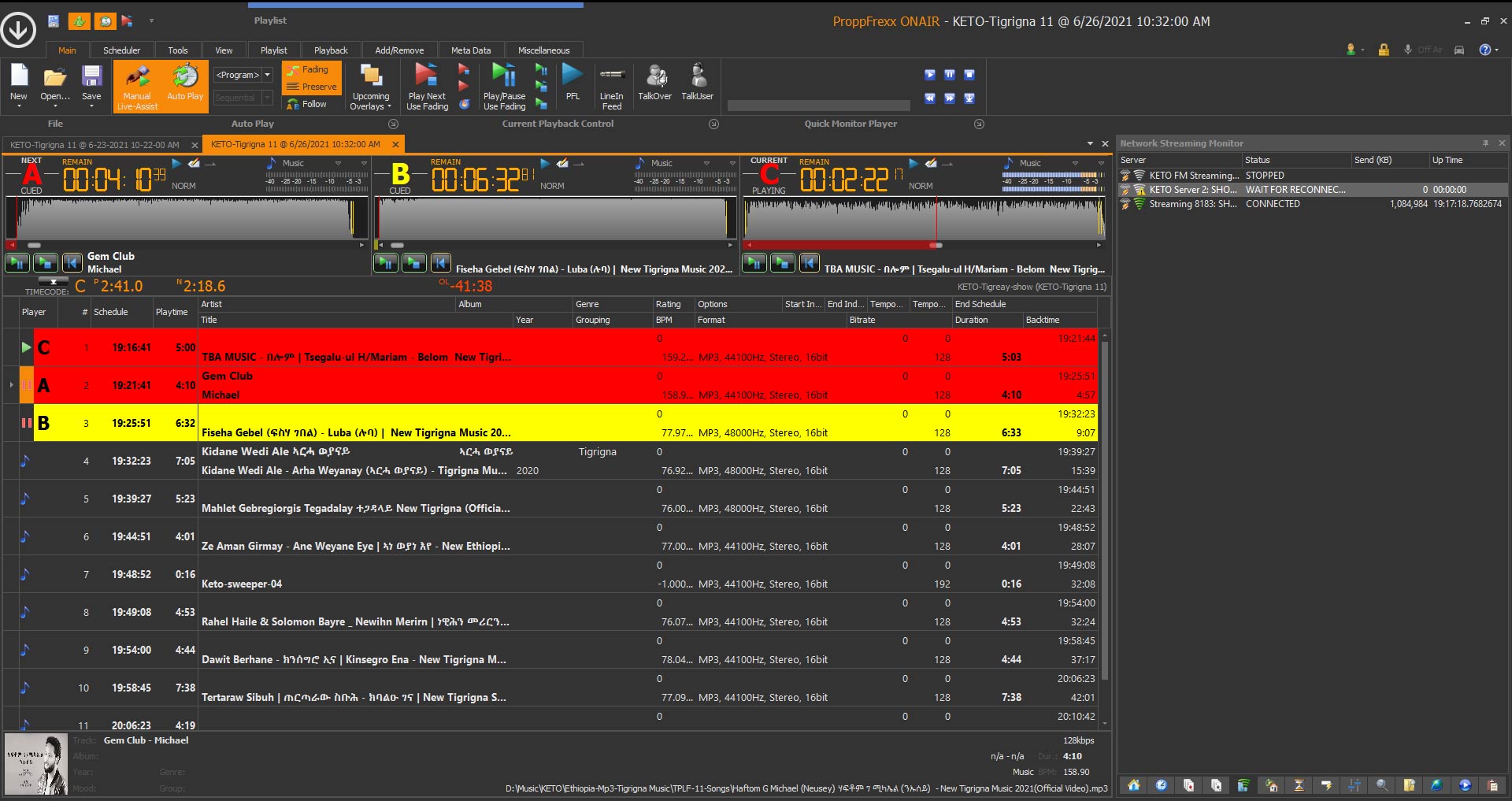

now the PSA airs but the "AutoPlay" is off than the playlist is not playing how the "AutoPlay" on top still on? whiteout me doing it
Posts: 8349
That depends on your program resp. Overlay settings. Especially the start toe of the program and if that was started by the program scheduler as well or if you started that manually or have in in manual live assist mode before?!
EG. show some screenshots of your program, overlay and explain if your scheduler is currently running and you mode…
