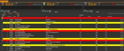

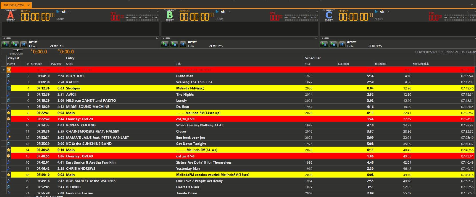

Sometimes the playlist for a remote voice track is not filled for the full hour. And then if you download your next hour, which uses the same script, your hour is completely fine. The script test is fine.

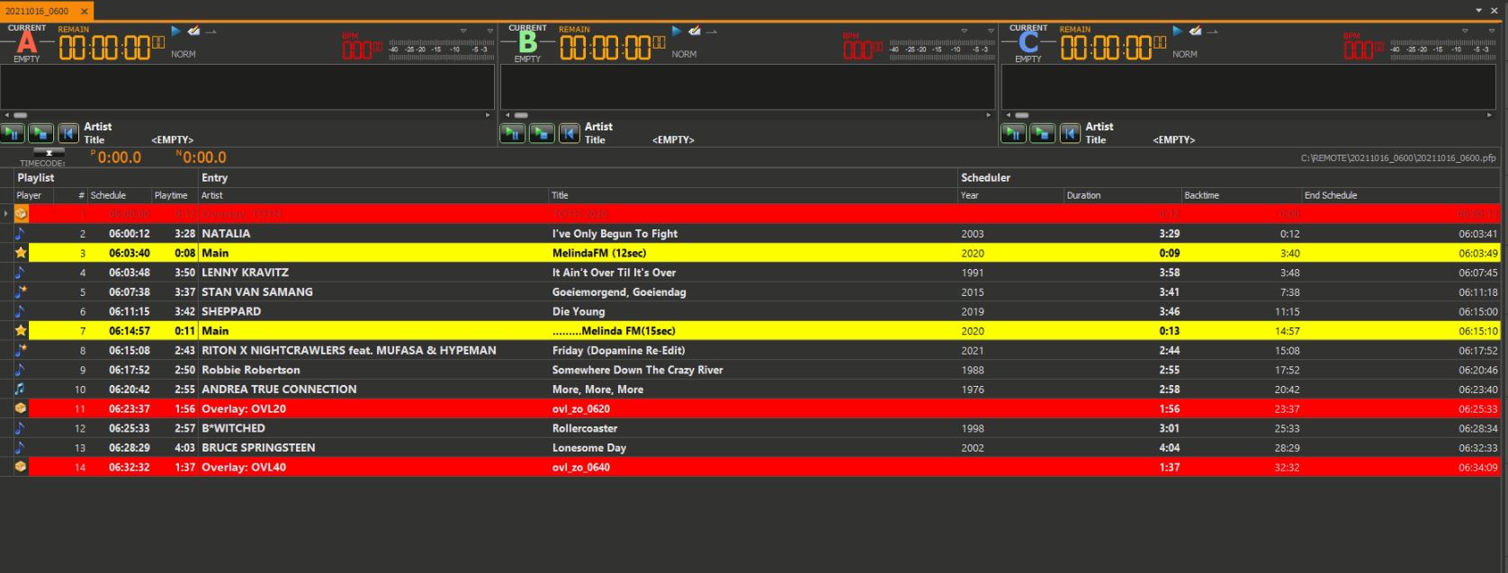

The program always set 1 hour and so on. And if you run a test script, it's fine.

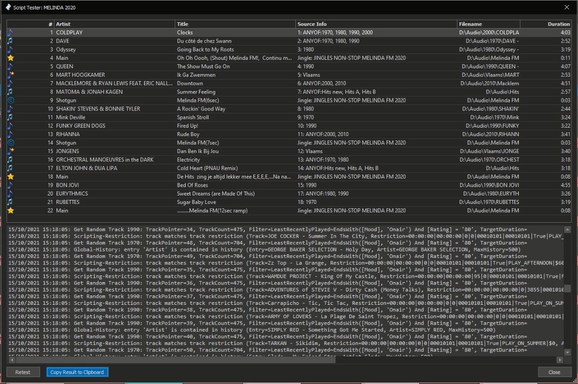

The script Test function only shows issues and warnings. E.g. that track restrictions couldn't play a track or that the history is violated.
Not sure, if you also have any track filters or rules enabled?
And thanks for providing the images. I am not sure, why the first Overlay entry is however blurred out?!
And to me it looks, like maybe the overlay's are not perfectly defined?! Or if the script execution is aborted due to a time or max tries limit?!
But when a script is normally executed okay, but sometimes not, this sounds like a criterion issue. E.g. even in your script test output, the script line #16 is skipped!
Maybe this also happends to other lines in some circumstances.
For example can you make a simple test:
Define a stupid script with all history etc. checks deactivated, use only a single library etc.
Make sure each script line doesn't do no history check, rule etc.
And then try this script for remote voice tracking.
Do you have still the same issue?
