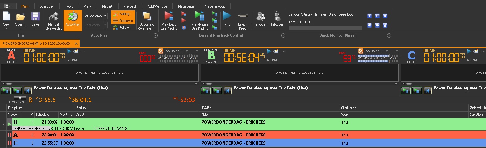

We have a live program that we bring in via a live stream. Now in the player there is the program name that is sent by the stream. Only it will not be forwarded to the encoder. What can I do to send the metadata thrue?

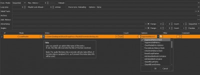

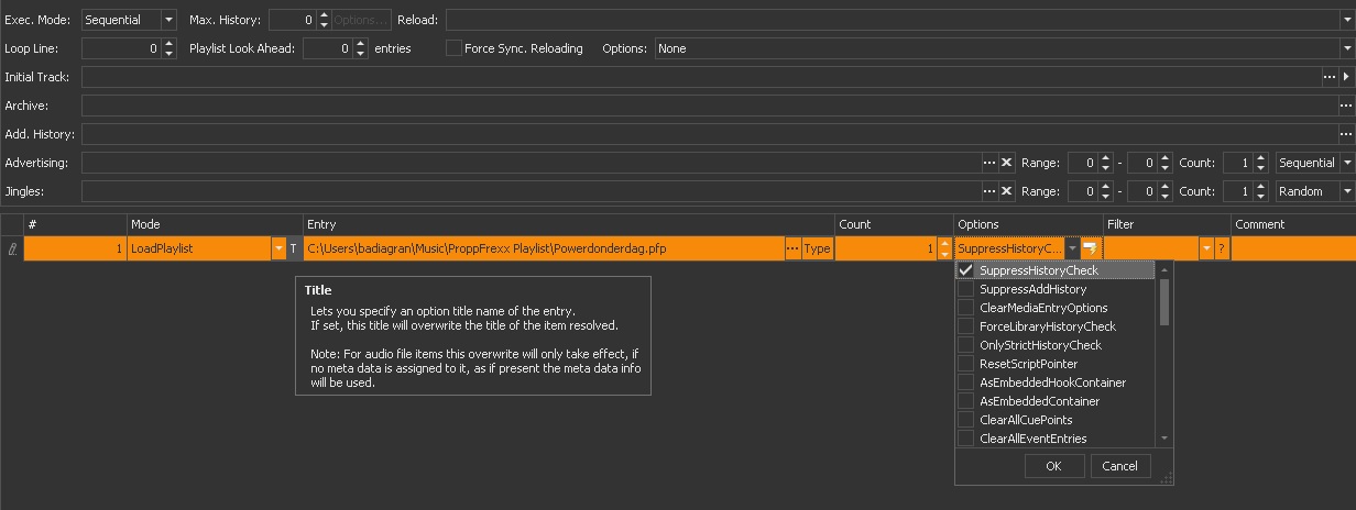

What if i want to send the Title of the show to the encoder? See attached what i mean.
Re: Metadata livestream
The you need to set the title format of the Streaming Server accordingly.
The ‘T’ title update won’t work with the LoadPlaylist mode.
