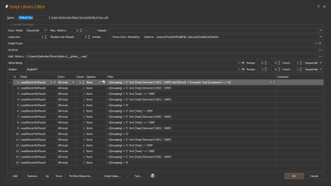

a) all music is planned by using scripts. I have basically two scripts; daytime and nighttime. Both scripts are (simplified explained) 4 times group "C" and then 1 time group "D". That's why I can easily check if the right music tracks are planned.
Music tracks are planned with 5 tracks in advance "on the fly"by the scheduler. In my playlist I can easily see (also backwards) if the defined 4xC and then 1xD is adhered to. As explained, this is not always the case during weekdays. I cannot predict when a certain music track is not played, because this seems to be random. Attached my DefaultDay format script.

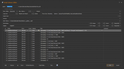

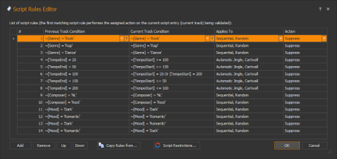

Unfortunately I can hardly see anything (but just a little), as the images are so small!
E.g. I can not see any details of your rules or script-line filters - but I guess in your script I can see the 5-1-5-1-5-1-5... pattern.
But note, that the script rules are evaluated AFTER the script-line tracks are executed/returned.
I.e. the suppress action is carried out at last.
Thus the 5-1-5-1-... pattern might change AFTER the script rules are evaluated, resulting in e.g. 5-1-4-0-3-1-4-1-5... or whatever pattern!
Meaning once a script-line returned its track(s), some of them might be suppressed due to the rules being evaluated!
This is by design and even wanted.
Maybe this fact alone explains your issues?

I was talking about the script rules and NOT the restrictions ;-) You are using both - so they might have an influence on each other - something I often call "you shot yourself into the foot".
But is the exact same script with the same rules running ever day?
And I am very sure, the issue is the script rules... but as said, I can even not see them in detail, as they are very small...but the debug log will almost contain them and tell me if one is matched or not.

I changed the script rules for tempo settings and have changed the weekend jingle again with the restricted days. Let me test a few hours again and I will get back to you tomorrow with my findings. Thanks again, JW.

Hi Bernd, yesterday I deleted some script rules regarding the use of jingles and after checking the playlists of last night the problem seems to be gone. What I still don't understand is why music tracks were skipped while the script rules were only defined for automatic jingles to make sure that at least the initial jingle tempo was in line with the outro tempo of the previous (music) track. Anyway, problem solved. Thanks again for your help. BRJW
