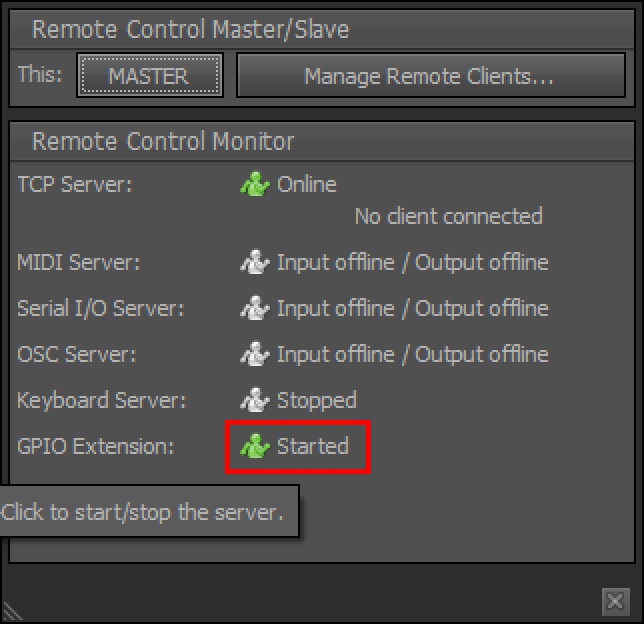

I have checked the box Enable GPIO Ext. Service in the GPIO/Remoting Tab. But when i click OK, no GPIO client is starting up. How do i fix that it is starting up automatically?radio42 wrote: ↑21 Oct 2021 21:50 No. When you enable the GPIO Ext. Service within ProppFrexx ONAIR in the general settings, the GPIO Client is started normally automatically. But all that can be configure in the general settings, section GPIO.

Re: ProppFrexx in combination with D&R Webstation, don't communicate
Just tested it here again and it does. How are you testing things?
Just disabling and re enabling the checkbox will not do this, as the checkbox in the settings (only) enables the GPIO Ext. Service at startup.
The effective status (started/stopped) of the GPIO Ext. Service can be checked in the Remote Control Monitor (RCM, see the main mixer channel popup). A double-click on the status label will effectively start resp. stop the service and also start or stop the related service apps, e.g. the GPIO Client.
That's the strange thing about it. I can't change anything in that screen as you can see on the picture.radio42 wrote: ↑21 Oct 2021 23:26 Just tested it here again and it does. How are you testing things?
Projekt 1.jpg A double-click on the status label will effectively start resp. stop the service and also start or stop the related service apps, e.g. the GPIO Client.
Is there a thing that i have to turn on before using the Remote Control?
Only the license edition. You need at least the Premium Edition to have the GPIO feature enabled.
And the TCP/IP service should also be enabled.
@royblokzijl: The issue should be solved, as it seems, that you are using the Basic-Edition - but any Remote-Control functions are only available starting from the Premium-Edition, see here: https://www.proppfrexx.radio42.com/editions.html
I have upgraded ProppFrexx to Premium and now the problem is solved. Many thanks for all your help!radio42 wrote: ↑22 Oct 2021 22:32 Only the license edition. You need at least the Premium Edition to have the GPIO feature enabled.
