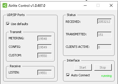

change GPIO Ext service from 4767 to 9042
change recieve port 18152 to 19550 and send port from 18153 to 19551
If I apply your settings here, it will not work either.
When i change it to 9042 it won't even make a connection, i get a connection error: 'Kan geen verbinding maken omdat de doelcomputer de verbinding actief heeft geweigerd: 127.0.0.1:9042.
If i change the receive port and send port to that ports (that are used by the Airlite), i have no connection with the D&R Webstation. The webstation is working with other ports. Maybe you could take a look with TeamViewer to see what's wrong? Or do you know another solution?

Airlite Control status?
