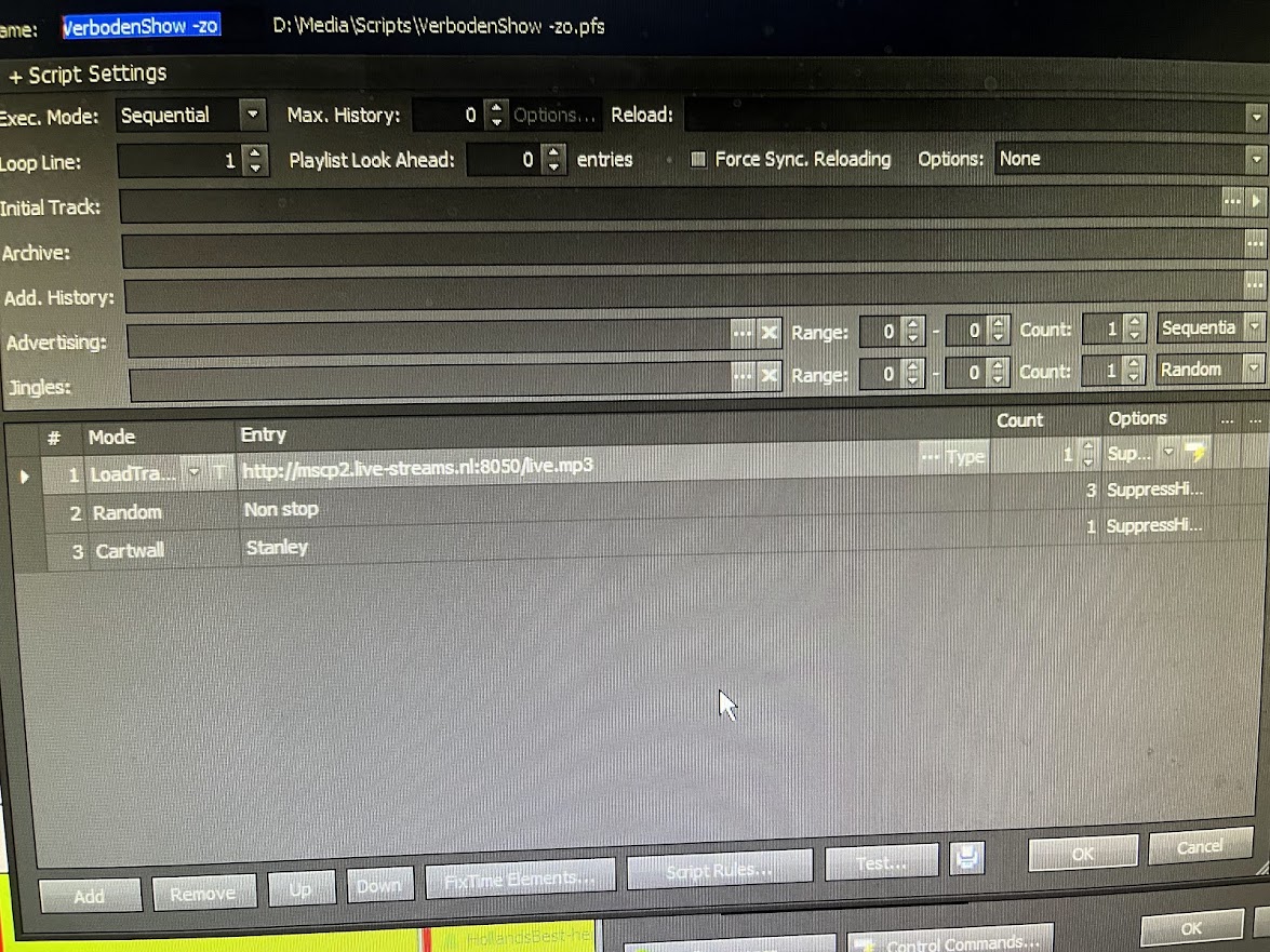

Hello Bernd,
When i start a script with a external live stream the script line where the live stream URL is gives 'file not found'
But i am sure that the live stream URL is good and working. Because when i put the live stream URL in the mod watcher there is audio

Still can you show how you use it in your script, eg. A screenshot of it. As well as a screenshot of the ‚error message‘… as I need some more details how you exact use it, the script-line mode etc.

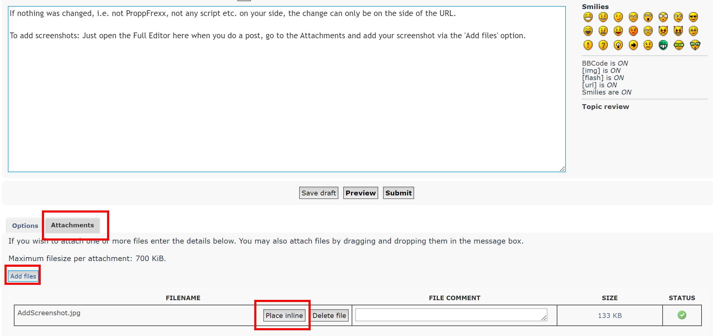

To add screenshots:
Just open the 'Full Editor' here when you do a post, go to the 'Attachments' and add your screenshot via the 'Add files' option.
WimHP
Posts: 34
Joined: 12 Sep 2017 19:56
Location: Den Haag
Re: script 'external live stream'does not work
Post by WimHP »
Here are the screenshots. The URL is ok because with the MOD Watcher Player is works fine with audio!

Posts: 8348
Now I see it -THX!
Btw, you can also directly do a screenshot when you use "Windows Key + Shift + S" key-combo (see here: https://www.businessinsider.com/guides/ ... on-windows)
However, I found the solution.
You just updated to the latest ProppFrexx version, which indeed contained a bug.
It is now fixed in the v4.3.3.10 version!
