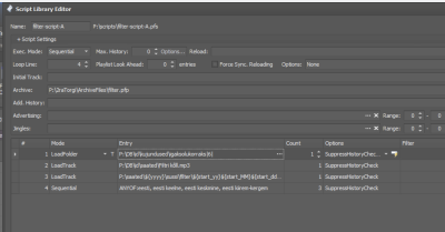

Actually for our use case it's make sense
We have quit a lot pre-recorded talkshows which are mostly ready on the same day or a few days before and are described accordingly in the system that program scheduler can take that file and but to on air. Depending on the time, there is no necessary program for that day and then we but some old show from that category to on air.
Depending on the show, the same show is played as a repeat in the evening or on a following day, and accordingly, the program is also described to take the corresponding archive file.
In this case, if we prepare the program manually ( Create playlist template) , we also have to add the repetition manually, ideally it could still work automatically

A Template Playlist by default resolves to a script loading the generated playlist with the following script-line:
I.e. it uses the following format:
The ${start} macro can be used in your repeated program to denote the effective start time of that program. Use it as again in a LoadPlaylist script-line, but we now have to subtract X hours to calculate and reference the generated playlist (in your example we have to subtract 12 hours) - i.e. like this:
(see the DATE control command function in the User Appendix of the User Manual for details)
LoadPlaylist,
C:\Path to your Pls\${start_yyyy}${start_MM}${start_dd}_${start_HH}${start_mm}\${start_yyyy}${start_MM}${start_dd}_${start_HH}${start_mm}.pfp
...\yyyyMMdd_HHmm\yyyyMMdd_HHmm.pfp
LoadPlaylist,
C:\Path to your Pls\*[DATE:{${start}}:{hours}:{-12}:{yyyyMMdd_HHmm}]\*[DATE:{${start}}:{hours}:{-12}:{yyyyMMdd_HHmm}].pfp

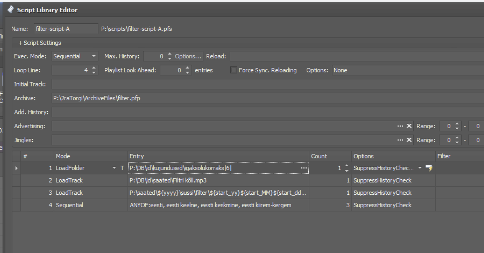

as an example, I gave a show with a time difference of 12 hours,
but if now the time of the first show is 16:30 and the repeat is 22:00 - does it also work as a minute calculation?
LoadPlaylist,
C:\Path to your Pls\*[DATE:{${start}}:{minutes}:{-330}:{yyyyMMdd_HHmm}]\*[DATE:{${start}}:{minutes}:{-330}:{yyyyMMdd_HHmm}].pfp

Right now I put test like this:
LoadPlaylist,
P:\2raTorgi\EditedTimes\${start_yyyy}${start_MM}${start_dd}_1630\${start_yyyy}${start_MM}${start_dd}_1630.pfp

Yes, you can also calculate the file name using minutes!
As such, you are correct: -330 minutes would mean minus 5h and 30 min. E.g. 22:00:00 -> 16:30:00
No, the *[DATE fuction always need a propper time value as the first parameter, i.e. the ${start} macro should be used.
E.g. when you wanto repeat a show exactly at the same time, but minus you can specify:
*[DATE:{${start}}:{days}:{-3}:{yyyyMMdd_HHmm}
